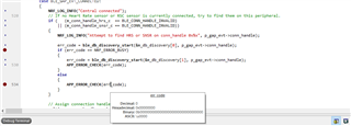

     From the relay debug log, it looks like the relay board connected with the sensor board. Could you check what err_code is returned by ble_db_discovery_start()? You should check where it stops in the ble_db_discovery_start function.
            case BLE_GAP_EVT_CONNECTED:
                NRF_LOG_INFO("Central connected");
                // If no Heart Rate sensor or RSC sensor is currently connected, try to find them on this peripheral.
                if (   (m_conn_handle_hrs_c  == BLE_CONN_HANDLE_INVALID)
                    || (m_conn_handle_rscs_c == BLE_CONN_HANDLE_INVALID))
                    NRF_LOG_INFO("Attempt to find HRS or RSC on conn_handle 0x%x", p_gap_evt->conn_handle);
                    err_code = ble_db_discovery_start(&m_db_discovery[0], p_gap_evt->conn_handle);
                    if (err_code == NRF_ERROR_BUSY)
                        err_code = ble_db_discovery_start(&m_db_discovery[1], p_gap_evt->conn_handle);
                    else

  • Hi Amanda. So I have different news today. Now the peer_manager_handler gives a message on Log saying that relay board is at central and the sensor board is at peripheral, that didn't append before. But the relay still cant connect to my service I think.
    So, here is what you asked for. It says that there's no error code there.

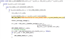

    And this log in the snsr_c_evt_handler never gets on screen, so I don't know where I'm failing.
  • UPDATE!
    Hi Amanda. So, I found the following.
    The evt_type is not returning what was suppose to return. It says that my service was not found at peer.
    I checked and the .srv_uuid.uuid and srv_uuid.type below evt_type,and they have the correct value.
    How can I supposedly fix this.
