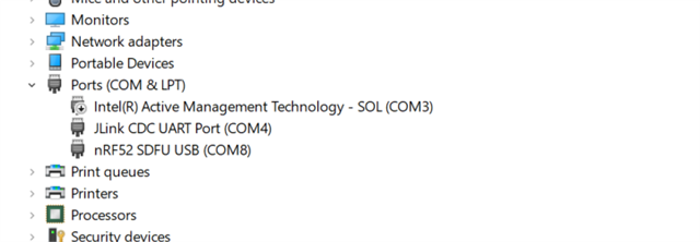

As you can see after building and run, I see using device manager that the SDFU USB peripheral is available for usb updating:
The problem is that when I try to do firmware update I got error messages, so that I cannot really understand if I got the USB bootloader compiled with the very right parameters,
or my problem is coming from a bad usage of nrfutil/ nrfutil version

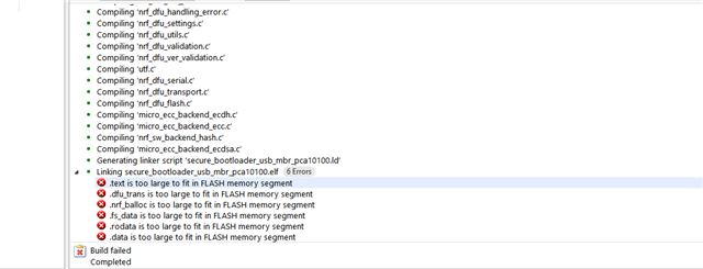

  • When using:
    linker_section_placement_macros="FLASH_PH_START=0x0;FLASH_PH_SIZE=0x80000;RAM_PH_START=0x20000000;RAM_PH_SIZE=0x20000;FLASH_START=0x78000;FLASH_SIZE=0x6000;RAM_START=0x20000008;RAM_SIZE=0x1fff8"
    linker_section_placements_segments="FLASH RX 0x0 0x100000;RAM RWX 0x20000000 0x20000;uicr_bootloader_start_address RX 0x10001014 0x4;bootloader_settings_page RX 0x0007F000 0x1000;uicr_mbr_params_page RX 0x10001018 0x4;mbr_params_page RX 0x0007E000 0x1000"
    I get this:
    that is way I used in the uploaded project (bootloader3.7z) this configuration:
    linker_section_placement_macros="FLASH_PH_START=0x0;FLASH_PH_SIZE=0x80000;RAM_PH_START=0x20000000;RAM_PH_SIZE=0x20000;FLASH_START=0x74000;FLASH_SIZE=0xA000;RAM_START=0x20000008;RAM_SIZE=0x1fff8"
    I saw in
    https://infocenter.nordicsemi.com/index.jsp?topic=%2Fsdk_nrf5_v16.0.0%2Flib_bootloader.html&cp=5_1_3_5_0_7&anchor=lib_bootloader_memory
    that boot start address should be 0x78000 to 0x7E000 (24kB). But should be the firmware like the one that I have compiled, it seems that there is not enough room, this way.

    But still I'll do some other test using RAM_START=0x20000008, because MBR is present and not SoftDevice in my case.
    FLASH_START=0x78000 and FLASH_SIZE=0x6000 seems to not be possible in my case, because bootloader is greater than 24kB. I mean, should be compulsory to get it started at 0x78000? Because it seems having it started at 0x75000 with 0x9000 size is ok. I still don't know, and have to do test if it is possible to optimize in a way that it fit the 24kB.
