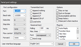

But if I try a serial-console (e.g. Gtk Term or TeraTerm), setting the baudrate to 115200 and using the same port as with the LTE Link Monitor, I get nothing. Nothing on ubuntu, nothing on windows.
Is there trick?
