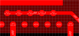

nRF52840 RESET Pin routing to avoid Pad on Via
Hi All,
I am using nRF52840 in one of our design. As the P0.18 is the RESET pin, it is tough to route the trace without a pad on via. Hence as I have modified my design by shorting the following pads: P0.18-->P0.19-->P0.21-->P0.23-->P0.25. I have done this by following the nRF 52840 Dongle PCB. I would like to know do we need to modify anything in firmware? Please let me know if its okay to connect this way. Awaiting early response. Thanks in advance.
