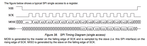

i'm trying to use SPI with nrf9160DK as master and RFM96 module as slave. At the moment, i'm developing elementary functions to write and read from my slave device. RFM9X module needs the following settings:
Word size: 8bit, CPOL=0, CPHA=0, Max SPI bus Frequency = 10MHz, CS Active Low, MSB first
The SPI timing sequence for a standard single access is the following:
The MSb of the address byte needs to be 1 if i'm writing, 0 if i'm reading the register.
The pin used in this test are placed in overlay file:

With this code i'm unable to get any consistent answer from my slave device (i noticed that i get always 8 or 0 if the address i use is even/odd...doesn't make any sense). This is a first bunch of fast questions about SPI:
- Is the spi config structure correctly set or i missed anything? In particular i want to be sure that i understood CPOL and CPHA setting;
- What about the "slave" element of spi config structure? I have 1 slave so i suppose i had to set it to 1, but is it really necessary?
- I'm having hard time getting a full grasp about "spi_buf" and "spi_buf_set" structure. While is intuitive understanding why "spi_buf" is structured like this, i don't understand why "spi_buf_set" has a "count" element. Why should i set an array or spi_buf struct?
- Is, in general, the flow described in the above picture reproduced by my code or i am missing anything?
    This is a critical point. No, the code i described doesn't work. This is the correct code:
    int spi_dev_read(struct device * spi_dev, const struct spi_config * spi_cfg,
                                                              u8_t reg_addr, u8_t * rx_data) {
      int err=0;
      //create the tx and rx buffer
      u8_t tx_buf[1]={SPI_READ_REGISTER|reg_addr};
      u8_t rx_buf[2];
      const struct spi_buf spi_tx_buf = {
    	.buf = tx_buf,
    	.len = sizeof(tx_buf),
      const struct spi_buf_set tx = {
    	.buffers = &spi_tx_buf,
    	.count = 1,
      const struct spi_buf spi_rx_buf = {
    	.buf = rx_buf,
    	.len = sizeof(rx_buf),
      const struct spi_buf_set rx = {
    	.buffers = &spi_rx_buf,
    	.count = 1,
      err = spi_transceive(spi_dev, spi_cfg,&tx, &rx);
      *rx_data = rx_buf[1];  //first byte is dummy, second one is the correct result
      return err;
    Please note that this time i used transreceive and not spi_write + spi_read. This is because when used the spi_cs_control structure as pointed here  both spi_write and spi_read pull low (at the beginning) and high (at the end) of the function at the end of the function, while many spi devices want that write (register address) and read (register value) happen in the same transaction. This can be obtained even using SPI_HOLD_ON_CS option, but i think is more efficient this way.
