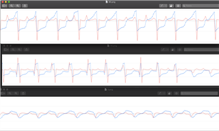

Hello. I try to configure radio at NRF52811 to prepare antenna switching and get correct I/Q samples from different antennas. I have 2 antennas that are 6 cm apart from one another. They are connected to the chip through RF switch BGS12SN6E6327XTSA1. I have 2 antennas that are 6 cm apart from one another. They are connected to the chip through RF switch BGS12SN6E6327XTSA1. It has a switching time of 0.4 μs and it’s control pin is connected to P0.22. As a basis, I took an example “radio” from SDK.

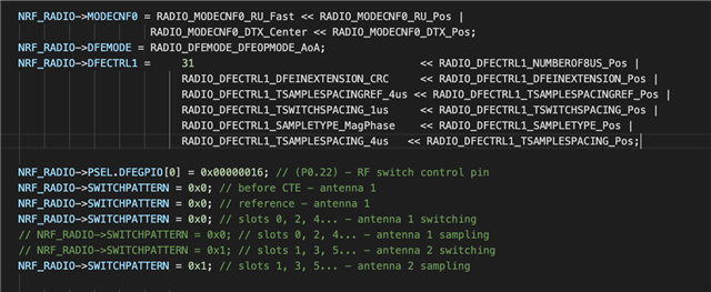

1. In function radio_config() I add some configuration (to the end of function):
2. In main() I add:
NRF_RADIO->PACKETPTR = (uint32_t)&packet;
where packet is an array for handle CTE info.
3. The code for the receiver and transmitter differ only in the call of the corresponding functions of reading or sending packets in the main loop.

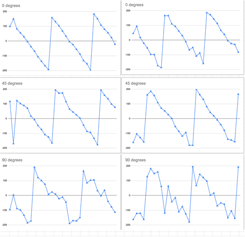

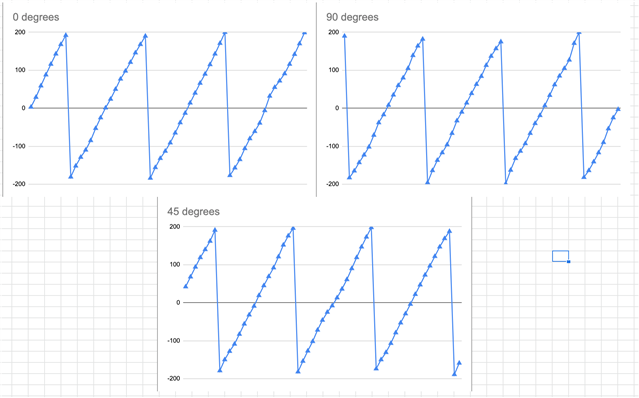

I got I/Q samples at different angles, but for a better understanding of the phase, I set up sampling on MagPhase instead of I/Q. In particular, I assume that 0.2.4 ... samples correspond to the first antenna, and 1.3.5 ... to the second. I assume that when all 3 antennas (2 at the receiver and 1 at the transmitter) are located on the same line (0 degrees), then the phase shift will be maximum, and when an isosceles triangle is obtained from the antennas (90 degrees), then the minimum. However, in practice it turns out almost the same picture, something like this:
I also understand that we work with frames, and not with waves in a straight line, so the question arises, if everything is correctly configured, will the phase shift obtained in this way correspond to the phase shift of the wave. What do I mean: if it were a phase diagram of a real electromagnetic wave with a wavelength of 12 cm, then in this case we would get a phase shift change from 0 degrees (antennas form a hip triangle) to 180 degrees (antennas lay on one line). And what should we get when working with frames?
So my questions:
1. How to configure radio to get samples from both antennas correctly (So that the phase shift somehow correlates with the angle between the antennas)?
2. How is the resulting phase shift related to the angle between the antennas? For electromagnetic waves, I understand the following: https://web.wpi.edu/Pubs/E-project/Available/E-project-101012-211424/unrestricted/DirectionFindingPresentation.pdf

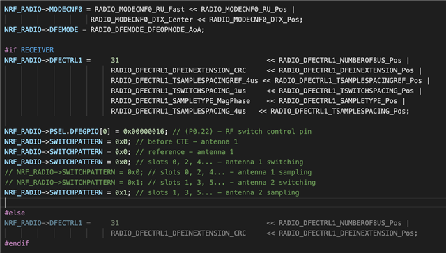

  • Hi Alex,
    I can't see your configuration, could you reload your first picture?

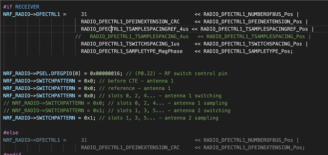

  • Hi. There is full config code:

        NRF_RADIO->MODECNF0 = RADIO_MODECNF0_RU_Fast << RADIO_MODECNF0_RU_Pos |
                             RADIO_MODECNF0_DTX_Center << RADIO_MODECNF0_DTX_Pos;
        NRF_RADIO->DFEMODE = RADIO_DFEMODE_DFEOPMODE_AoA;
        #if RECEIVER
        NRF_RADIO->DFECTRL1 =     31                                    << RADIO_DFECTRL1_NUMBEROF8US_Pos |
                                  RADIO_DFECTRL1_DFEINEXTENSION_CRC     << RADIO_DFECTRL1_DFEINEXTENSION_Pos |
                                  RADIO_DFECTRL1_TSAMPLESPACINGREF_4us << RADIO_DFECTRL1_TSAMPLESPACINGREF_Pos |
                                //   RADIO_DFECTRL1_TSAMPLESPACING_4us   << RADIO_DFECTRL1_TSAMPLESPACING_Pos |
                                  RADIO_DFECTRL1_TSWITCHSPACING_1us     << RADIO_DFECTRL1_TSWITCHSPACING_Pos |
                                  RADIO_DFECTRL1_SAMPLETYPE_MagPhase    << RADIO_DFECTRL1_SAMPLETYPE_Pos;
        NRF_RADIO->PSEL.DFEGPIO[0] = 0x00000016; // (P0.22) - RF switch control pin
        NRF_RADIO->SWITCHPATTERN = 0x0; // before CTE - antenna 1
        NRF_RADIO->SWITCHPATTERN = 0x0; // reference - antenna 1
        NRF_RADIO->SWITCHPATTERN = 0x0; // slots 0, 2, 4... - antenna 1 switching
        // NRF_RADIO->SWITCHPATTERN = 0x0; // slots 0, 2, 4... - antenna 1 sampling
        // NRF_RADIO->SWITCHPATTERN = 0x1; // slots 1, 3, 5... - antenna 2 switching
        NRF_RADIO->SWITCHPATTERN = 0x1; // slots 1, 3, 5... - antenna 2 sampling
        #else
                                  RADIO_DFECTRL1_DFEINEXTENSION_CRC     << RADIO_DFECTRL1_DFEINEXTENSION_Pos;
        //NRF_RADIO->CTEINLINECONF = RADIO_CTEINLINECONF_S0MASK_Msk;
    main (main parts of it):

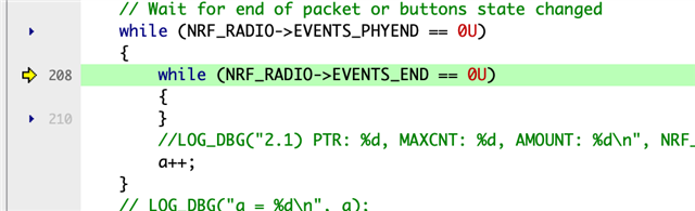

        while (NRF_RADIO->EVENTS_READY == 0U) {}
        NRF_RADIO->EVENTS_END  = 0U;
        NRF_RADIO->TASKS_START = 1U;
        while (NRF_RADIO->EVENTS_PHYEND == 0U)
            while (NRF_RADIO->EVENTS_END == 0U) {}

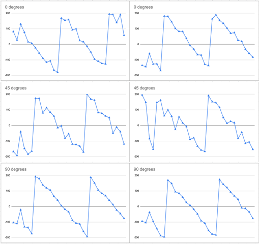

  • Hi, yes, I'm tried an equal number for TSWITCHSPACING and TSAMPLESPACING. But in this case no packets at all was received.
  • What values should I put in DFECTRL2 and DFEPACKET.MAXCNT?
    Thanks
    1) your i_q array is too small - for 31*8 usec, even with 4-usec sampling, you will get (2+31*2)*4=256 bytes. Also it's safer to set DFEPACKET.MAXCNT to the maximum number of samples your array can hold.
    2) you need to configure PACKETPTR and allocate a memory for it, even if you don't expect any bytes to exchange. I would create some small payload with CRC, thus you can check at receiver side that packet is received correctly and you can trust AoA samples. (there is another point - you're configuring DFE after CRC event, how it will work when CRC is disabled?)
    3) leave TSAMPLESPACING with some documented value, nobody can tell what's happen when it's zeroed.
    4) I would not rely on PHYEND at receiver side as it's not documented. For now, just add nrf_delay_us() after getting END event to wait while all samples are received.
  • So, I did:
    1. larger array (2048 val.)
    2. set DFEPACKET.MAXCNT = 2048
    3. TSAMPLESPACING == TSAMPLESPACINGREF = 125ns
    4 . different. setting for receiver and transmitter
    5 . DFECTRL2 = 0 for now (don't know which offsets i should put there)
    #if RECEIVER
                                  RADIO_DFECTRL1_TSAMPLESPACINGREF_125ns << RADIO_DFECTRL1_TSAMPLESPACINGREF_Pos |
                                  RADIO_DFECTRL1_TSAMPLESPACING_125ns   << RADIO_DFECTRL1_TSAMPLESPACING_Pos |
        // I don't kwow which offsets I should put there
        NRF_RADIO->DFECTRL2 = 0 << RADIO_DFECTRL2_TSWITCHOFFSET_Pos |
                              0 << RADIO_DFECTRL2_TSAMPLEOFFSET_Pos;
    #else

    Also I got I/Q data in MagPhase format and built graphs for different angles. And it's still seems like it doesn't switch correctly:
    What about  DFECTRL2 and SWITCHPATTERN? Maybe I configure them wrong?
    #if RECEIVER
    #else
  • You didn't enabled CRC. I don't know whether DFE can start without CRC if you configure RADIO_DFECTRL1_DFEINEXTENSION_CRC.
    a sample is two 16-bit values, you need 4096 16-bit cells. MAXCNT is in samples units (2048 is right).
    SWITCHPATTERN seems to be correct. Do you have an ocsilloscope to look at P0.22 - is any switching takes place? Also you can try to configure RADIO_DFECTRL1_DFEINEXTENSION_Payload at receiver side to catch your payload as I/Q samples - you should see up/down slope for bits 0/1.
  • At the moment, I found out that there are problems with the antenna switch and with the external antenna. As soon as I eliminate them, I will continue to try
    Have you actually looked at P0.22 using a scope or logic analyzer to see if it is toggling or not?
    Andreas
  • I've some updates:
    1. RF switch and both antennas work correctly, switching occurs.
    2. I changed the settings a bit:
    Also I changed MAXCNT: NRF_RADIO->DFEPACKET.MAXCNT = MAXCNT1 / 2;
                                  RADIO_DFECTRL1_DFEINEXTENSION_Payload     << RADIO_DFECTRL1_DFEINEXTENSION_Pos |
                                  RADIO_DFECTRL1_TSAMPLESPACINGREF_1us << RADIO_DFECTRL1_TSAMPLESPACINGREF_Pos |
                                  RADIO_DFECTRL1_TSAMPLESPACING_1us   << RADIO_DFECTRL1_TSAMPLESPACING_Pos |

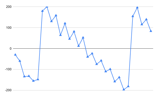

    3. I expect that in this configuration, switching between antennas will occur after each sample. I have received the following phase graphs (0-45-90 degrees):
    Something still seems wrong...
  • Now you're receiving your payload as I/Q samples (RADIO_DFECTRL1_DFEINEXTENSION_Payload). I suggested it just to look at phase graph - whether you're receiving something meaningful, but with 1-us sampling we won't see anything.
    Did you try to enable CRC with RADIO_DFECTRL1_DFEINEXTENSION_CRC setting? And leave sampling interval of 0.125us for now - there will be much clear picture. There should be a continuous graph except the gap after first 8 us. Here you can see my results (though I use different algorithm to get phase value): samples 0-63 are for reference period, then the gap (first switching slot), then switching/sampling slots.
