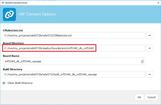

I want to do this without changing the files in my installation of ncs, so I thought I should use what is explained in part 2 of the tutorial, section 2.1.2 User workflow - Application as the manifest repository
I figured that in SES I would still use File > Open nRF Connect SDK Project, but I should point the board directory to my copy of zephyr for the project:

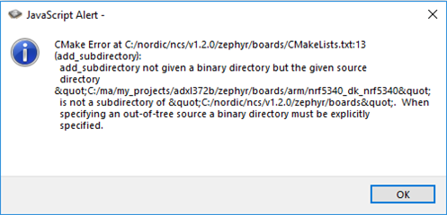

But when I click OK I get this alert

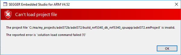

Then this error
Is there a better way to do this?
