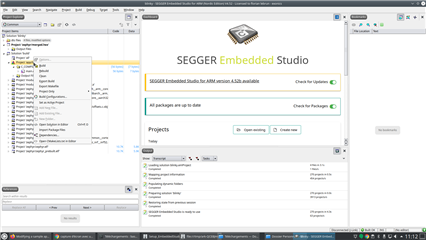

Problem 1: CMake List:
Unlike to the tutorial, option to manage CmakeList are not present.
Problem 2 : Add new files:
I can't add files, and moreover, sometimes the add new files is there sometimes not, just by clikcing right several times on project folder.
I've never succeed in adding a folder too.

    I'm seeing the same thing as you regarding problem 1. However, when I open a sample from nrf instead of zephyr, I see the options. So I'm not sure what's going on, but I'll look into that.
    Regarding your second question, it's not clear to me what you're having issues with. When you right-click on the project, you're not seeing the "Add New File..." etc. options? Or sometimes you are, and sometimes you're not?

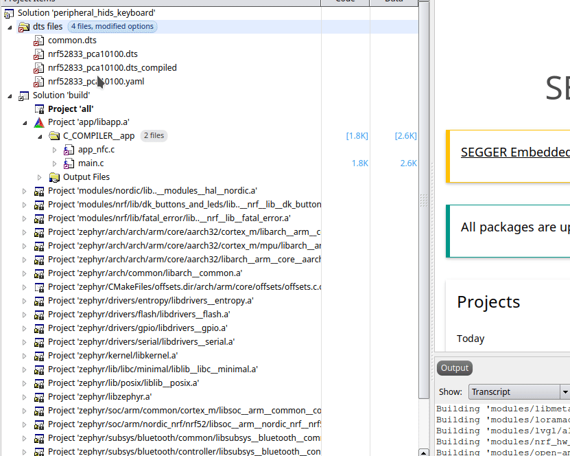

  • Hi Heidi , i have found the second problem !
    To have the context menu with Cmake option stuff, it seems we need to add #NORDIC stuff around taget sources !
    To sum up :
    SOLUTION Probleme 1 :
    build.emproject replace :
    <import can_modify_solution="No" file_name="build.emProject"/>, by
    <import can_modify_solution="Yes" file_name="build.emProject"/>,
    SOLUTION Probleme 2:
    Surroung target_sources with :
    # NORDIC SDK APP START
    target_sources(app PRIVATE ${app_sources})
    # NORDIC SDK APP END
    So i dont't know really why but it works...

  • Thank you ! There is really stuff to do here because even when i create folder, it doesn't appear in linux tree. Moreover, i had the experience where it desapear also in SES. and each time i re import the project ( because dts change for example) option No comme back. So i deicided to put all my files in src. I have the feeling that we should create a kind of external librairie like all the other "projects" of the project.

    And to viez .h , should we start a new librairies ? Becasue when i add my header files in subfolder, it disappear and doesn't stay in C_complier_app. How do you work with your differents source files usually with SES ? I have never seen this kind of project arichecture... It is a pitty, because the rest is quiet ok .
  • I'm trying to do what you're describing and having a lot of trouble with it, as well.
    To add source files in a project, I recommend you just use the file explorer on your computer to add them. Changes to your project in SES (such as adding files or adding configurations) don't get saved between closing and opening the project again, so doing that through SES is not recommended by us.
