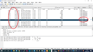

i use the hex
sniffer_pca10056_129d2b3.hex
the packet is
nrf_sniffer_for_bluetooth_le_3.0.0_129d2b3.zip
my board is nrf52840- dk
but the wireshark only capture the packet on 37 38 39?
why?
no bonding
just le connect.
could you tell
i use the hex
the packet is
why?
no bonding
just le connect.
could you tell
Those are the 3 advertizing channels in the BT LE specs. Advertisements and connection requests will only appear on these channels.
Other channels will only be captured following a user interaction, i.e. selecting a specific device.
why? do you mean my hardware nrf52840-dk couldn't capture the packet on the data channel (except 37 38 39)?
what's your mean specific device?like ?
Hi
You only see these three channels because these are the channels used for regular BLE advertisements, connection requests, etc. As Turbo J is saying, the DK can capture packets in the other channels, but there is rarely activity there unless you do a specific interaction in your application trigging data to be sent on those channels.
