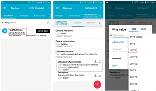

2) Similar to nRF Mobile app how to see RAW data of Advertisement packet in nRF Desktop connect tool.
3) Using nRF Connect app, I am able to select type of data. But how to do the same in nRF Connect desktop tool. I am not seeing such options.
