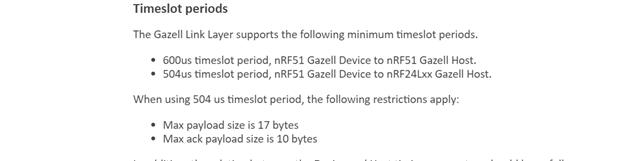

no.1,about the max packet  payload
i browser the nordic web,deferent min timeslot means deferent max  packet  payload.
but in the file nrfready_desktop_2_v3.0.0\source_code\nrfready_desktop_dongle\gazell\common\gzll.h show the packet payload is 32.And in the nordic devz ,some anwsers show it conld be 32.
so what is the real max packet  payload?

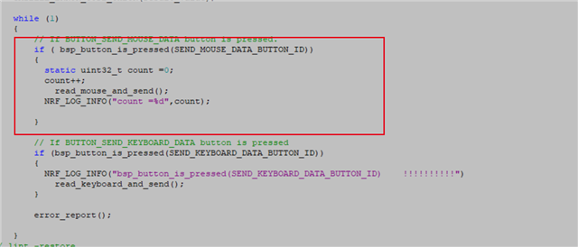

in the project  nRF5_SDK_16.0.0_98a08e2\examples\proprietary_rf\gzll\gzp_desktop_emulator,i modeify the code ,and the nrf24lu1p dongle insert in the pc ,i use USBlazer to observe the usb info

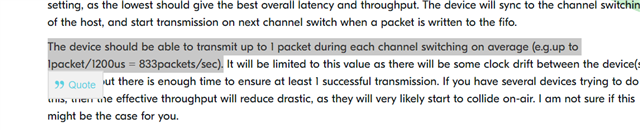

i prees the mouse key 5s,i see in the rtt,the count is 280.and the  USBlazer's result too. the timeslot in my device code is 504,the GZLL_DEFAULT_PARAM_RX_PERIOD in the nrf24lu1p's dongle is 1008,as say
 https://devzone.nordicsemi.com/f/nordic-q-a/11404/gazell-frame-rate-too-low?ReplySortBy=CreatedDate&ReplySortOrder=Ascending
the gzll can send 833packet  per second,Obviously the packet of my device send is too little. so what is the problem ?
