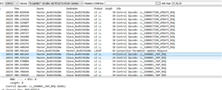

The issue is after it connects 8 peripherals, the Android APP will frequently disconnect immediately after establishing the connection. The reason of disconnection is connection timeout. BUt at the same situation, the IOS APP connect it well.
It seems that the more peripherals it connect, the more frequently disconnected from Android APP.
The BU connected 8 appliances android.pcapng and Disconnect.png are the log of sniffer and nRF connect for the Android system. And the device connected 8 peripherals.

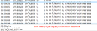

    The trace you have for Android looked a little bit strange. When there is a disconnection of timeout, I don't see the central tried to re-transmit packet before the disconnection. It simply stopped which is pretty strange.

    I found that the sniffer traces didn't show all the communication due to the connection was switched to 2Mbps and the sniffer can't sniff 2Mbps communication.
    You may want to disable 2Mbps in the ble_app_hrs_rscs_relay code to force the phone not switching to 2Mbps. Or use a sniffer that can track 2Mbps communication.

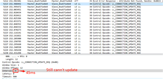

    Below is disable 2Mbps, Use sniffer to sniff the communication. Analyze the communication data as follows:

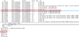

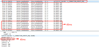

    The connection interval for the CONNECT_REQ is 45ms. But the communication interval in the figure below is less than 7.5ms

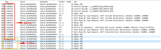

    About 800ms later of CONNECT_REQ, the master will update the connection interval to 7.5ms.
    The connection interval is update to 7.5ms.
    Then the communication may be busy. The slave cannot reply to the master.
    After about 3 seconds, the master re-update connection interval to 45ms.

    1. Is the connection interval updated to 7.5ms for android automatic update or nRF Connect APP update?
    2. Can a slave refuse to update a connection interval of 7.5ms? If it can, how can I fix it?

    The request to switch to 7.5ms is from the Android phone. The reason it does that is to reduce the time it takes to do service discovery. Usually when thing goes as planned it will switch back to long connection interval. However in this case for some reason when switching to 7.5ms the softdevice wouldn't managed to handle the connection (with other 8 connections to the appliances).
    This is performed by the Android OS and not the app, so I don't think it's easy to get rid of that. On bonded device the phone won't do service discovery every time it connects though. This could be an option.
    Also there is no way the peripheral (BU) can reject the request to change connection interval to 7.5ms. It's controlled by the central.
    There is an option is to increase the interval to the peripheral from 75ms, hopefully that would reduce the issue.
    Another option is to temporarily disconnect one or some of the peripherals and wait until service discovery is finished and connect them back. It wouldn't take too long, like 1 seconds, depends how you configure the peers. This would be a little bit cumbersome but would work I think, I just don't know the requirement to keep the connection to other peers.
