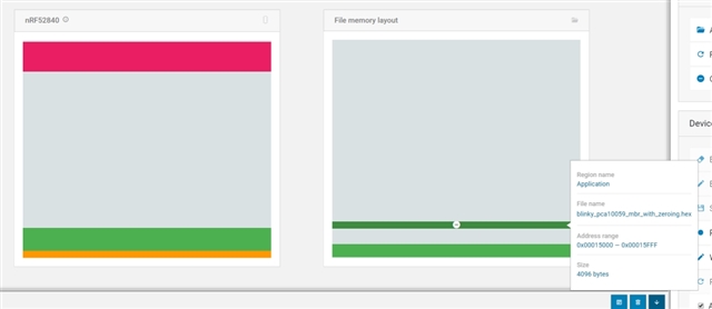

Erasing gazell pairing memory.
Environment - windows 10, ses release 4.12 nRFconnect programmer 3.3.3 using gnu C nRF52840 dongle programming with DFU. No softdevice, Gazell only.

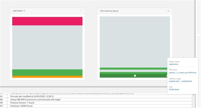

I have two hex files, one containing my nrf52840 dongle program and the other containing the program plus a section erasing 4k of memory from 15000
With the same difference between .hex files (but obviously not identical .hex files) using ses and Jlink on the PCA10056 dev kits, both .hex work just fine.
If I use nRFConnect v3.3.3 programmer to load the one containing just the program onto a dongle, all runs just fine.
If I use nRFConnect programmer to load the one which also erases the 4k of memory, the program does not run at all, when powering up the dongle it goes into bootloader mode without pressing the reset button.
They are built using ses. The only difference in the build is in the file "flash_placement.xml".
The only difference in that file is in the line:
<ProgramSection alignment="4" keep="Yes" load="No" name=".GZP_PARAMS" start = "0x00015000" size="0x1000" />
which is changed to:
<ProgramSection alignment="4" keep="Yes" load="Yes" name=".GZP_PARAMS" start = "0x00015000" size="0x1000" />
There is not a single character of difference in either the .map file or the section of the .hex file which contains the program.

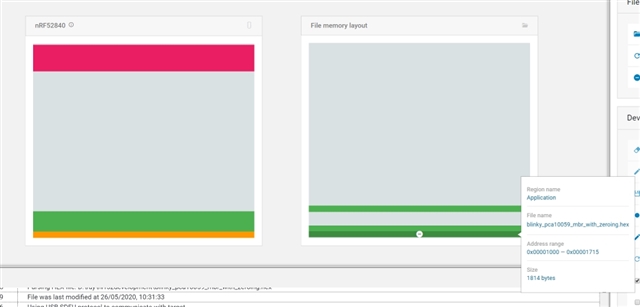

Just to prove a point, if I edit out the above lines erasing the memory from the hex file and then use nrfconnect programmer to write the resulting .hex the program runs just fine.
If I write the program containing the erase, and then re-write it with the one without the erase, then it works just fine AND it looks like the erase actually worked i.e. I have to re-pair the client with the server dongle.

  • Hi Raymond,
    The protocol that nRF Connect uses to program the nRF528540 dongle is the DFU protocol. The nRF Connect automatically switch the dongle to bootloader mode and flash the board via the bootloader. The USB bootloader can be found here: https://infocenter.nordicsemi.com/topic/sdk_nrf5_v16.0.0/ble_sdk_app_open_bootloader.html?cp=7_1_4_4_2
    The protocol is here: https://infocenter.nordicsemi.com/topic/sdk_nrf5_v16.0.0/lib_dfu_transport.html?cp=7_1_3_5_2
    The nRF Connect when given a hex file, will first convert it to a binary file. This is the place where your 4K of all 0xFFFFFFFF is realized. My assumption is that in the binary generated, there will be all 0xFFFFFFFF all the way from the end of your application until address 0x15FFF.
    NRF Connect will send all these 0xFFFFFFFF to the bootloader, and the bootloader will also write 0xFFFFFFFF into the chip, there will be no check.
    The question is why it worked for the firmware with no 4K of blank at 0x15000 and it didn't work when there is that 4K.
    What we can do is to read out the hex dump from the dongle, and check the difference.
    From what you described that the device enter bootloader without going to the application, it may suggest that the CRC check was failed.

    I assume your application already made with start address at 0x1000 ? (to avoid the MBR)
    Yes, you will see that from the screen captures that I posted. Also, please remember, without the zeroing the memory, the application works fine as does the DFU after I press the reset button to trigger it. (my application does not know about DFU). I have checked very carefully, there is no difference in the .hex files in the part which contain the program between the ones that FFFFFFFF the memory and the ones that do not.
    Exactly so. Why does blinky work, and not my application?

  • Hi Ray,
    You can read the hex dump by connecting a programmer (nRF52 DK) to the dongle. This requires you to solder the header on port P1. and then use a 10 pin cable to connect the debug out port on the DK to this header. This way you can access the dongle flash directly without using the bootloader (you can program the dongle ). Then you can read the code out either using nrf connect or use "nrfjprog.exe --readcode" command line tool.
    But I think I found what could be wrong here. It's the CRC check failed. Most likely because your code will write to the 4K "blank area" to store gazell data. And because of that CRC will fail. The bootloader expecting your application as a whole from 0x1000 to 0x15FFF. And any modification to flash in this range will result in CRC check fail on booting. And the bootloader will enter DFU mode.
    When you don't include the "blank area" the bootloader wont check the address from 0x1000 to 0x15FFF but only to the last address of your code, meaning writing to 0x15000 won't affect CRC.
    So I think the easiest solution is still to use 2 binaries, one to erase flash, and one to start normal application. Or you can include a feature in the code to erase that 4kB of data when you press a button or when you send a command. For example, when application detect you hold SW1 when plug the dongle in USB port, it erases the 4kB flash.
