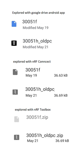

    There is definitely a difference, I did a whole DFU process with nRF Connect, but could not even start a process with Toolbox, the file selector visually look the same to me, How would I know if they are actually different? How can I import the file differently?
    Update - the problem is probably not the nrfutil tools or any .zip generation tools that I have, because now I see that just adding new files to the drive, even ones that were generated before that are creating the same problem. also I tried with a third workstation, and the problem persists. so basically it's like any new file I am adding to the drive (I actually tried from 2 different google drives as well) has this issue.

    I found out that downloading a file that was uploaded with the new workstation, to the old one, and then re-uploading it (from the old workstation) makes it selectable again
    This is how the different files looks from different explorers, 30051f.zip is not selectable, 30051h_oldpc.zip is selectable.
    Any more insights will be very much appreciated
