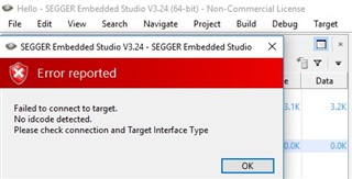

I have a weird issue on connexion with my J-link while connecting to my chip. I'm using a NRF52810 which worked very well until now. When I try to connect to the J-link to load my program it shows me this :
I first thought that my ship was broken, but I checked my 2.7V and the last program seems to run well.
Then I checked my debug pin, but I didn't found shortcuts current.
