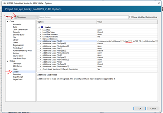

    nRF5 SDK version 16 is probably the best SDK for nRF52833 unless you have a particular reason for using nRF Connect SDK. It is correct that many examples are not adapted to it, but adjusting an existing example takes just a few minutes once you know what is needed.
    For reference, I started off with the BLE bliky example for nRF52840 in SDK 16, for SES (\examples\ble_peripheral\ble_app_blinky\pca10059\s140\ses\ble_app_blinky_pca10059_s140.emProject).
    1. Adjust the linker configuration macros to be correct for the flash and RAM size of the nRF52833, and the reduced size of the S113 SoftDevice:
    2. Adjust the preprocessor defines to specify the correct board, IC and SoftDevice:
    3. Adjust the include path to include S113 headers instead of S140 headers:
    4. Make SES load the correct S113 SoftDevice when programming from SES:
