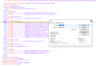

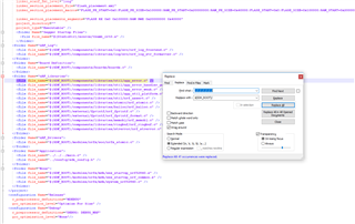

    It seems like the most commonly used approach is to make a copy of the example project and simply keep it in the same SDK directory as the original one. But as I've tried to illustrate by the screenshots below,  it's possible with relatively few steps to move an example outside of the SDK tree if you can edit the xml formatted project file with a text editor that supports "search&replace".
    Moving SDK example to a different location.
    1. Pick an example project that best fits the requirements and copy it to your workspace.

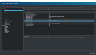

    2. Open project files you just copied in SES and add a new project macro that points to your SDK copy. To make sure the setting is applied globally for all configurations, open the project settings at the top level ('Solution') and add the macro under the 'Common' configuration.
    3. Now we can replace the relative source paths with the macro we added in step 2.
    4. That's it. Now you only need to update the SDK_ROOT macro if you want to move the project.

  • Vidar, thank you; I will give this a try. It is very difficult for me to see the details of the embedded pictures on my machine (my eyesight is not great). I'm guessing, I download the attached zip file, unzip, and add it as a global macro in step 2; I can't make out exactly where to add it from the picture, but I think I might be able to figure it out from the text. Regarding step 3, again I can't make out the details, but I'm guessing the window that is opened is a search and replace window. I'm not used to using a "macro" in a search and replace window; I'm guessing this might be an option specific to SES? Anyways, I will give it a try. Your e-mail has been useful in telling me: 1) there is no automated way, but by: 2) carefully choosing where to copy a project to, and 3) using some of the existing tools with the down-loaded macron, it shouldn't be too difficult.
  • Thank you Vidar, being able to see the screen shots made all the difference. I now realize that the "Macro" was simply setting a value for the environment variable SDK_ROOT which could then be used in the search and replace window. For some reason, clicking on the screen shots did not enlarge them previously, it does now and it makes it completely clear.
  • Thanks for the update. Glad to hear that it worked.
