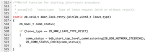

Instead I have tried another way which leaves the network, but it will rejoin the same network again even after the 3 minutes of bdb permit (running against the cli example) it does not seem to have cleared all data neccesary.

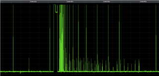

A current measurement with an erased chip that is scanning for network, and after a few tries the coordinator is started (bdb start) and the device joins.

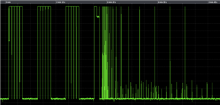

A current measuement where the joined device is instructed (locally) to leave the network, but it rejoins directly:

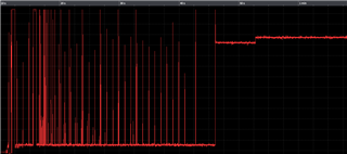

current measurement when using  zb_bdb_reset_via_local_action(0), it is stuck with an increased current consumption of about 5mA:

/**@brief Function for starting join/rejoin procedure.
 * param[in]   leave_type   Type of leave request (with or without rejoin).
static zb_void_t door_lock_retry_join(zb_uint8_t leave_type)
    zb_bool_t comm_status;
    if (leave_type == ZB_NWK_LEAVE_TYPE_RESET)
        comm_status = bdb_start_top_level_commissioning(ZB_BDB_NETWORK_STEERING);
        ZB_COMM_STATUS_CHECK(comm_status);

zigbee-traffic.pcap
    The increased current consumption may be related to a bug in T&Z SDK4.1.0 is caused by a bug. It is related to sleep time. Try to apply the attached patch, and see if that helps:
    0001-Fix-long-zigbee-sleep-periods.patch
    As for leaving the network. Check out the command zdo mgmt_leave in the SDK4.1.0\examples\zigbee\experimental\cli. Check out the implementation there. To do a hard erase of the network data, check out the function zb_set_nvram_erase_at_start(), which is called on startup if ERASE_PERSISTENT_CONFIG is set to ZB_TRUE.
    BR,
    Edvin
  • Thanks a lot for that patch, sorted another issue that I was going to pursue later, a spontaneous increase of power consumption after 10-20 seconds of 2mA ca.

    <info> app: BLE Zigbee dynamic door lock example started.
    <info> app: Production configuration is not present or invalid (status: -1)
    <info> app: Zigbee stack initialized
    <info> app: Network left (leave type: 0)
    <error> app: Unable to start BDB commissioning at /work/src/app/doorlock/main.c:523
    <error> app: ERROR 1 [RET_ERROR] at /work/src/app/doorlock/main.c:523
    <pressed reset here>
    <info> app: Device started for the first time
    <info> app: Start network steering
    <info> app: Started network rejoin procedure.
    <info> app: Joined network successfully (Extended PAN ID: f4ce36e5090728eb, PAN ID: 0x6032)
    <error> app: ERROR 29 [RET_OVERFLOW] at /work/src/app/doorlock/main.c:841
    the second error at row 841 leads to the bug: https://devzone.nordicsemi.com/f/nordic-q-a/61638/confused-about-polling-interval
    For leaving the network, I did not really understand the instructions. the zdo mgmt leave command is meant to send out from the coordinator right? The function I'm looking for is something on the end device trigged by the user.
     zb_set_nvram_erase_at_start will that work right away or after next boot? shall I call that end then reboot to make it bite directly? and if so will it reset itself afterwards so that the device will keep its data when switching batterys?
    leave-from-ezsp.pcap
    Sorry for the late reply.
    Unitware said:
    I see some errors occasionally in the log, not every boot, not sure if they are related.
     What is (was) at main line 523, and what was the function call that returned the value that was checked by the error handler? Did it return 1 immetiately, or is this in a callback? May it be that bdb_start_top_level_commissioning() is already called at this point?
