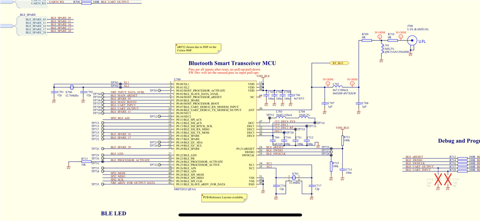

Low Power Current Consumption in NRF52832
I'm using ble_uart_app and wanna Low Power Current Consumption but its consuming 330uA. disabled the nrf_log form sdkconfig file. main code is below. Please let me know what else need to be disabled to get lowest current.
bool erase_bonds;
sd_power_dcdc_mode_set(NRF_POWER_DCDC_ENABLE);
NRF_POWER->DCDCEN = POWER_DCDCEN_DCDCEN_Enabled;
nrf_gpio_cfg_input(31, NRF_GPIO_PIN_PULLUP );
nrf_gpio_cfg_output(22);
nrf_gpio_cfg_output(3);
nrf_gpio_pin_write(22, 0);
nrf_gpio_pin_write(3, 0);
