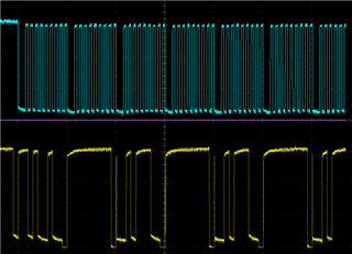

I am using nRF52840 to communicate with the EEPROM. 24AA32AT-I/MC over I2C interface. The TWI scanner example detects the EEPROM address correctly for me .Now, I want to read/write the EEPROM.

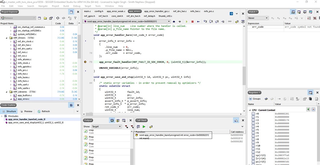

    I am using sdk 16, SES ,nRf52840 the simulated EEPROM example with an actual EEPROM (24AA32AT-I/MC) connected but I am not using any of the CLI/UART features of the example. Instead, I am trying to write direct TWI read and write functions, see attached code. In the write function, I am trying to write (0xff) to the EEPROM located at 0x52 address. During debugging and the the execution of write function, I am getting a DRV_TWI_ERR_ANACK error 0x0000820. I don't understand why I am getting this NACK . As you can see in the attached scope picture, the data pin is low on 9th clock pulse, hence it should be a perceived as ACK by the  nRF52. One interesting fact is that by using the same hardware settings, I am able to poll EEPROM address (0x52) while using the twi scanner example.
    If I remove all the breakpoints from the code and let it run its full course then I get the following condition, which I can only get out only by asserting the reset pin on nRF52.

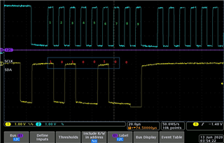

    The DRV_TWI_ERR_ANACK error code has value 8201, for future reference.
    From the looks of it, you are receiving an ACK with the SDA being low at the time of the ACK bit, so lets look into the error that is being generated.
    When you do have the breakpoint, this is where you get the DRV_TWI_ERR_ANACK error?
    And if not, could you step through the code and see where the error is generated?
    Is your call to nrf_drv_twi_rx successful?

  • Karl,
    I had to insert a delay between read and write after which the code is working fine now.
    Moving forward, since TWI driver is deprecated so I am trying to switch to the TWIM driver. After looking through nrf_drv_twi.c/.h , I am concerned that nrf_drv_twi.c/.h code seems to handle both the TWI and TWIM requests through various if conditions. For example  twim_evt_handler(),nrfx_twim_init() functions uses twim, see attached code of the nrf_drv_twi.c .
