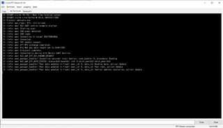

What is the current status:
1. The Peripheral (ble_app_uart) is able to connect to the iOS app "nRF Connect".
When connected to iOS app "nRF Connect", I can see the device advertising, connect to the device, notify from the device, disconnect from the device. Everything working correctly.

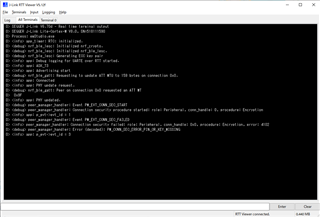

2. The Peripheral (ble_app_uart) is not able to connect to Central (ble_app_uart_c).
When try to connect to the Central device (ble_app_uart_c), it shows connected (green rectangle in below image) at first but then disconnected (red rectangle in below image) after 1 second.
(P.S. To minimize unknown problem, I execute delete_bonds everytime when the Peripheral or Central is power on)

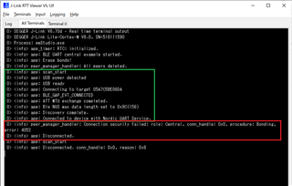

This is the RTT output of Central device.
The error message shows that connection failed due to connection security failed (error 4352).
In this forum post (https://devzone.nordicsemi.com/f/nordic-q-a/49894/peermanager-error-error-4352), 4352 is PM_CONN_SEC_ERROR_DISCONNECT.

    You can see where this error is printed:
    It is from the PM_EVT_CONN_SEC_FAILED event in pm_handler_pm_evt_log() from peer_manager_handler.c:
                NRF_LOG_INFO("Connection security failed: role: %s, conn_handle: 0x%x, procedure: %s, error: %d",
                             m_roles_str[ble_conn_state_role(p_pm_evt->conn_handle)],
                             p_pm_evt->conn_handle,
                             m_sec_procedure_str[p_pm_evt->params.conn_sec_start.procedure],
                             p_pm_evt->params.conn_sec_failed.error);
    You can see that the error number is printed as a decimal value (%d), so this means that the decimal value is 0x1100. So what does that mean?
    Looking at the type of the p_pm_evt->params.conn_sec_failed.error, which is an pm_sec_error_code_t, you can see from the description that it is:
    /**@brief Errors from security procedures in Peer Manager.
     * @details Possible values are defined in @ref PM_SEC_ERRORS and @ref BLE_GAP_SEC_STATUS.
    typedef uint16_t pm_sec_error_code_t;
    (from peer_manager_types.h, line 74-78)
    So from @defgroup PM_SEC_ERRORS:
    #define PM_CONN_SEC_ERROR_DISCONNECT         (PM_CONN_SEC_ERROR_BASE + 0x100) /**< @brief Pairing or encryption did not finish before the link disconnected for an unrelated reason. */
    (PM_CONN_SEC_ERROR_BASE is 0x1000)
    So the error you receive is because of the disconnect.
    Are you prompted with any pairing questions when connecting with nRF Connect for Desktop? Did you try to click the settings icon of the connection and click pair (and check of "bond")?

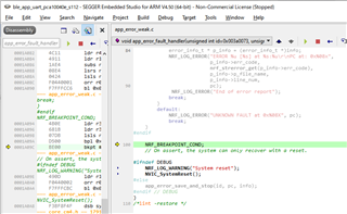

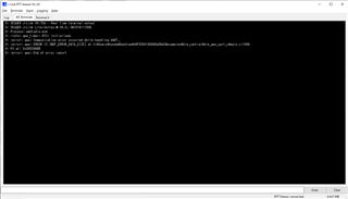

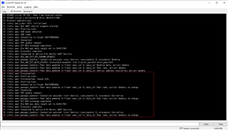

    Problem #1:
    However, if I turn the Central off, and turn it on again, it shows the following error:
    ERROR 12 [NRF_ERROR_DATA_SIZE]
    (The error is occurred on Central side, not Peripheral side)
    (The Central program is based on the example ble_uart_c)
    NRF_LOG_ERROR("Communication error occurred while handling UART.");
    APP_ERROR_HANDLER(p_event->data.error_communication); // Line 1006
    And I can only erase the Central and re-download the program again.
    I have read several posts talking about this.
    Most are on Peripheral side, but mine is on Central side.

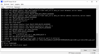

    Problem #2:
    After problem #1 occured, the pairing no long success.
    When trying to connect, the error of 4102 is returned.
    4102 => 0x1006 => PM_CONN_SEC_ERROR_PIN_OR_KEY_MISSING
    Is there any hint on the above two problems?

  • sdtjoe said:
    Thank you for your suggestion.
    I have moved the uart_init() from main to the event handler of event BLE_GAP_EVT_CONNECTED, so the UART will only init after BLE is connected. And also I have created a flag to make sure it run only once.
    And the problem seems to be fixed. I will do further test on this later on.
     Good! An alternative is to just ignore the COMMUNICATION_ERROR event unless the device is connected. You can experiment with different workarounds.
    Make sure the allow_repairing is set to true in the device that did not lose the bonding information. Or set it in both devices, if there is a chance that they both lose it.

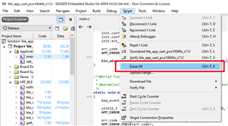

    I have added a log to print when PM_EVT_CONN_SEC_CONFIG_REQ is being called in pm_evt_handler.
    However neither Central or Peripheral the event PM_EVT_CONN_SEC_CONFIG_REQ is not being fired.
    So I think the allow_pairing did not set at all.
    case PM_EVT_CONN_SEC_CONFIG_REQ:
    NRF_LOG_INFO("PM_EVT_CONN_SEC_CONFIG_REQ");
    pm_conn_sec_config_t conn_sec_config = {.allow_repairing = true};
    pm_conn_sec_config_reply(p_evt->conn_handle, &conn_sec_config);

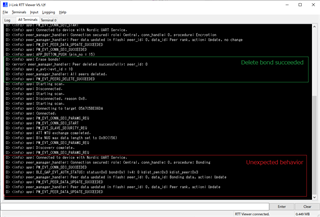

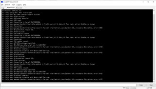

    Here is my steps and observation:
    Scenario 1 (No problem at all):
    1. Turn on both devices which are never connected.
    2. They will bond.
    3. Turn off either Central / Peripheral and they will connect again.
    4. Press delete button on Peripheral side, PM_EVT_PEERS_DELETE_SUCCEEDED event is fired.
    5. Try to connect again, PM_CONN_SEC_ERROR_PIN_OR_KEY_MISSING, which is my expected behavior.
    Scenario 2 (Unexpected behavior):
    2. They will bond.
    4. Press delete button on Central side, PM_EVT_PEERS_DELETE_SUCCEEDED event is fired.
    5. Try to connect again, the devices connected successfully. But I expect it should be rejected as I have deleted the Central bonding in step 4.
    Maybe I have missed some setting on either side?

  • Hello Joe,
    I am a bit confused:
     But from the latest screenshot of the log, the line before "Unexpected Behavior" says:
    "PM_EVT_CONN_SEC_PARAMS_REQ" (not the same, but similar). From peer_manager_types.h:
    /**< @brief Security parameters (@ref ble_gap_sec_params_t) are needed for an ongoing security procedure. Reply with @ref pm_conn_sec_params_reply before the event handler returns. If no reply is sent, the parameters given in @ref pm_sec_params_set are used. If a peripheral connection, the central's sec_params will be available in the event. */
    Do you reply with pm_conn_sec_params_reply? Do you get any events on the peripheral at this point in time?
    Where did you set .allow_repairing = true in the central?
    BR,
    Edvin

  • Hello Edvin,
    Just like some additional observation.
    Instead of deleting bond by pressing button to call delete_bond from the problem, I tried Target > Erase All to remove the whole device memory by J-Link.
    (The observed result is same as previous.)
    Scenario 1:
    If I perform remove all to the Peripheral, the Central can no longer connect due to PM_CONN_SEC_ERROR_PIN_OR_KEY_MISSING.
    Scenario 2:
    On the otherhand, if I perform remove all to the Central, the Peripheral still can connect again.
    According to the observation, I understand the situation as follow:
    Scenario 1 proved that the Central is actually remembering the Peripheral, because when the Peripheral device is cleared the key is also lost, therefore, the "old" Central rejects the connection of the "new" Peripheral?
    Scenario 2 proved that the Peripheral is not remembering the Central, because the Peripheral can connect to a "new" Central, even it has been bonded with the "old" Central.

  • Hello Edvin,
    Scenario 1:
    Scenario 2:
    So I guess the problem is due to some security or bonding setting?
    I think should look for the problem from the code on Peripheral side rather than on Central side.
    Best Regards,
    Joe
  • I don't think I follow what you are doing anymore. If one of the devices still has bonding information and the other one doesn't, I believe you should get an event to which you should call a reply with .allow_repairing = true or false. I believe this event is the PM_EVT_CONN_SEC_CONFIG_REQ event.
    If you are not sure how whether your bonds are deleted, I suggest you work with manually erasing the chip for now, until you figure out how to handle the different setups (one device having the bonding information, while the other doesn't).
    Edvin

  • Hi Edvin,
    I have solved the problem finally. It is because I missed the whitelist in the Peripheral side.
    After integrating the whitelist by referencing example ble_app_hids_keyboard, the Problem #2 is fixed.
    After some simple tests, bonded device will only connect to each other correctly.
    And I found a new problem about advertising on Peripheral.
    Background:
    There is a button on Peripheral, the button will erase the the saved bonding information on Peripheral. And the same for Central.
    After erasing, I want the device to restart scan for Central and advertising for Peripheral.
    Scenario:
    (Code sample are below)
    1. Peripheral and Central are bonded and connected.
    2. On Peripheral, press on the button to call advertising_start(true), which will call delete_bond().
    3. pm_peers_delete() will trigger event PM_EVT_PEERS_DELETE_SUCCEEDED in pm_evt_handler.
    4. PM_EVT_PEERS_DELETE_SUCCEEDED event will call advertising_start(false)
    5. When ble_advertising_start is called, the error NRF_ERROR_CONN_COUNT is returned.

    I found that the error is from sd_ble_gap_adv_start(...), line 653 of ble_advertising.c
    if (p_advertising->adv_mode_current != BLE_ADV_MODE_IDLE)
    	ret = sd_ble_gap_adv_set_configure(&p_advertising->adv_handle, p_advertising->p_adv_data, &p_advertising->adv_params);
    	if (ret != NRF_SUCCESS)
    		return ret;
    	ret = sd_ble_gap_adv_start(p_advertising->adv_handle, p_advertising->conn_cfg_tag);		// Line 653
    		return ret;
    According to nrf_error.h:
    #define NRF_ERROR_CONN_COUNT (NRF_ERROR_BASE_NUM + 18) ///< Maximum connection count exceeded.
    Does it mean that I cannot advertise when there is an active connection?
    If so, does it mean that I have to disconnect from Central before start to advertise?
    Best Regards,
    Joe
    Thanks for sharing your progress. It is very useful for other users who encounter similar problems.
    The softdevice can only have a certain number of connections (declared in the application). If you are in a connection, and you have set the maximum number of connections to 1, then sd_ble_gap_adv_start() will return NRF_ERROR_CONN_COUNT. So in your case, you are probably still connected, and you start advertising again.
    If you only intend to support one connection at the time, you need to disconnect before you start advertising. Deleting the bonds will not disconnect your current connections, so you need to do this "manually".
    Perhaps your button handler can disconnect from the central before it deletes the bonds. Remember that disconnecting can take some time, especially if you have a long connection interval. If so, perhaps you should set a flag (a local variable), and disconnect. When you get the disconnected event, you can check this flag, and call advertising_start(true) if the flag is set, and advertising_start(false) if the flag is not set (just a normal disconnect).
    If you intend to support more than one connection, you need to increase the connection count. Please refer to the multilink examples. ble_app_multilink_central for multilink central, and ble_app_multiperipheral for multiperipheral.
    Edvin
