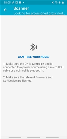

Hello everyone. I have the following issue: I would like to connect some Nordic Thingy:52 nRF6936 devices in a mesh network, using the application nRF Mesh. In theory, the first step should be very simple (there is also an official video about this: https://www.youtube.com/watch?v=XthbU9NP0Yg).
However, in practice, my nodes are not found. Is there some previous set-up which needs to be made? Do you have any suggestions?
Remarks: I have the latest version of the app + all firmware updates and the nodes are recognised in other apps, for example in Nordic Thingy App or nRF Toolbox - nRF Connect App.

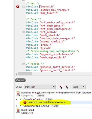

  • Hello! I solved the last problem by copying the mesh-provisioning-demo folder in the SDK_for_Mesh folder, because I saw that there is the boards.h file that I was looking for Slight smile

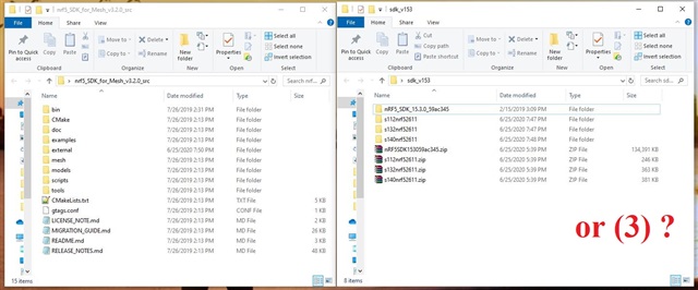

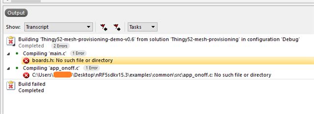

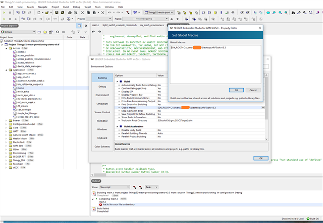

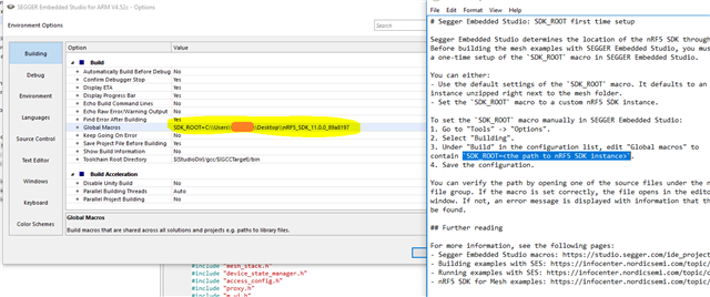

  • Hello again! It seems like it was not a good idea to copy those files in another folder, because there are more erros now. So I just want to solve the problem of not being able to find hal.h file.. It seems to me like I'm so close, but somehow these dependencies cause me to be stuck on this for two weeks now..
    1. Could you please guide me what I sould do to debug this error with hal.h file missing?

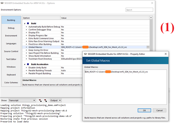

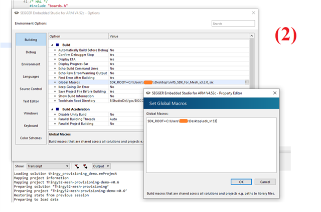

    2. I followed very strictly the steps from Git. The only one that I'm not sure about is Step 9. Make sure you followed the SES.md guide in \doc\getting_started in nRF MESH SDK v3.2.0 of adding SDK_ROOT macro into SES, the same as when you started with Mesh examples. So I have two folders. My question is: in SES, should I point to:
      (1) nrf_SDK_Mesh_v3.2.0 ? or
      (2) nrf_SDK_v15.3 ? or
      (3) some other file inside one of the folders?
    I attach all 3 possibilities, to be on the same page.
    Thanks.
  • 1. You are probably getting this if you missing the include file. Might be solved if your SDK_ROOT macro is correct.
    2. You should point to the nRF5 SDK. (2). I see you have put the nRF5 SDK inside a mother folder so you have to change the path to "SDK_ROOT=C:\Users\...\Desktop\sdk_v153\nRF5_SDK_15.3.0_59ac345"
  • Hello! Thank you for helping me, I eventually managed to do it. It was quite some trouble, so I would like to point out for whoever has this problem in the future:
    - in the GitHub tutorial, at step5. Clone this repo into \examples\ --> it refers to the Mesh Folder (not to the sdk_v15 folder).
    - plus, the SDK root in Segger Program needs to be pointed to the folder that I outlined in picture (2) above.
    Thank you very much for your support!
