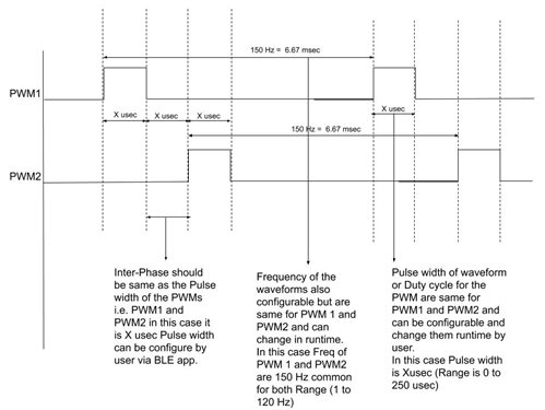

    Let me share my overall concept behind this or output of waveform as below.
    Here There are two GPIOs in which i want to form waveforms as above
    1) PWM 1 and PWM 2 : That has frequency as well as duty cycle if PWMs or pulse widths as user perspective. NOTE: PWM1 and PWM2 should have same freq and duty cycle of pulse width .
    Range for Freq user can vary from Application is 1 to 150 Hz and Pulse width would be 0 to 250 usec.
    2) Interphase delay or delay between two PWMs would be exactly same as the Pulse width or duty cycle of the PWMs .
    I have got all two parameters from the user ie frequency as well as Pulse width.
    Just clear me the concept of implementation to produce the waveforms on CRO or physically in nRF as above.
    From your diagram it apppears that the two PWM's will always have the same frequency - this enables you to only use 1 timer instance, as mentioned in my previous comment. From your diagram it also seems that the two PWMs always will have the same frequency and duty cycle - only the inter-phase offset changes between them?

  • From your diagram it also seems that the two PWMs always will have the same frequency and duty cycle - only the inter-phase offset changes between them?
    Actually Interphasing delay should be same as the duty cycle for the PWM.
    So if user changes the duty cycle the interphasic delay also changes and should be same as duty cycle of the PWM.
    both "Pulse width" and "duty cycle" to refer to the duty cycle of the PWM, I would prefer that you only use the term duty cycle. If you are referring to something else when you say "pulse width", please elaborate what this is.
    Ok now Suppose the diagram I saw you is waveform that I want to create using two GPIOs so there should be two possibility whether by PWM (duty Cycle) or Timer (pulse width) .
    Now as per User perspective whether to use PWM or Timer the final result would be the pulse width if we coin the term using Timer and if we use PWM then Duty Cycle.
    But the end result should be as per posted diagram.
    I hope i make it more simple now to make you understand.
    Please suggest me the option to generate the waveform using two GPIOs and interphase delay.

    I understand. This would be the same as calculating the duty cycles length in time, and adding that as an offset to the CAPTURE/COMPARE register, like I referenced in my previous comment.
