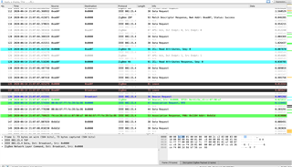

Can the TCLK timeout be changed?  I have a ZigBee device that joins and performs a key exchange but then is forced to leave the network 12 seconds later due to a TCLK timeout.
Please see the following sniffer screenshots.
Key Exchange

    From the sniffer trace it looks like assosiation and key exchange is perform correctly, but then the coordinator sends a mgmt Leave request to the device, there could be many reasons for this so I need more information. How do you know the reason the Leave message is sent is a timeout? What are you using as the coordinator of the network? What kind of device are you trying to use to join the network?

  • TCLK is the Trust Center Link Key and is part of the authorization used for for newer ZigBee devices.  The sniffer screenshots I attached above are from a PCA10056 DK acting as a coordinator (custom firmware).  I'm trying to connect a ZigBee keyfob to my coordinator.  This particular version of the keyfob doesn't have an install code.
    I know it's a timeout error because of my RTT log which I have attached.  You will see that I the stack sends a Device auth timeout.
    I have also tried the keyfob with the ZigBee CLI example and I get the same result.  The sniffer trace for the CLI test has an End Device Timeout Request.  So maybe this is the cause.  I have attached the sniffer trace from the CLI test too.
