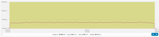

    CC310_BL Hash:

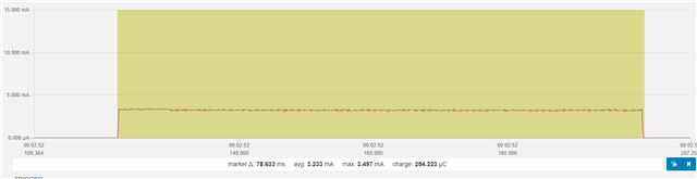

    nRF_Oberon Hash:

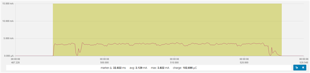

    CC310_BL Verify:

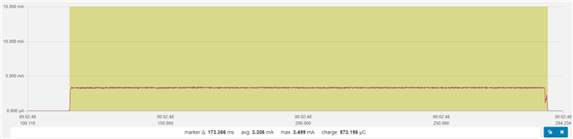

    nRF_Oberon Verify:
    As you can see, the average current is very similar for both backends, but the time consumed by the nRF_Oberon software backend is approximately 4-5 times the CC310 crypto backend.
