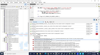

Observed that Openthread CLI project in NCS v1.3.0 is not compiling as it is using Segger Studio but building with command line. Please fix this.
Thanks
Sridhar
Thanks
Sridhar
Looks like I get the same errors. I will report this to the developers. Note that Thread support is only for evaluation purposes in this release:
"nRF53 Series devices (which are pre-production) and Thread, Zigbee, and Bluetooth Mesh protocols are supported for development in v1.3.0 for prototyping and evaluation. Support for production and deployment in end products is coming soon."
I would recommend building using command line until it is fixed.
Jørgen
Hi again,
I received feedback from our Thread developers that this is a know limitation, and is mentioned in the release notes.
Jørgen
