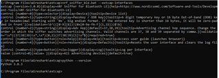

Ran the sniffer tool in CMD. (Successful)
Added Wireshark Profile. (Successful)
But still, i cannot see the nRF on the interface... Where did I go wrong on my procedures??

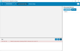

i tried running the nRF52840 DK in the BLE nRF Connect but faield to open the port. But using the nRF Programmer is fine.
Could this be the root of the problem???

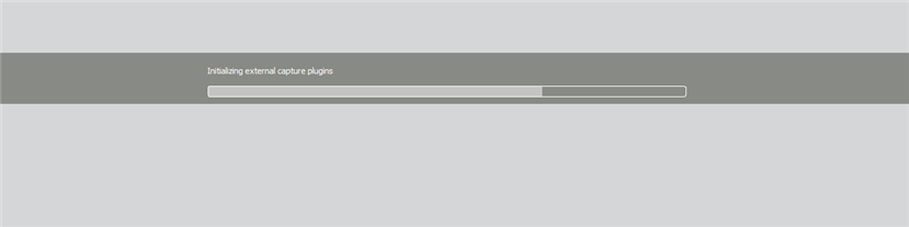

    Could you tell which version of wireshark you used ?
    When you open wireshark do you see this in the loading screen (take ~30s on my computer) ?
