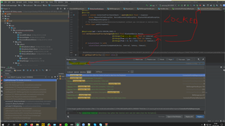

  • Regarding the other application, it was created using MIT App creator name APP Inventor V2, using blocks of code, so I cannot access the code behind the blocks in order to see the connection parameters.. It is a simple drag and drop application creator.
    I did not modified the connection parameters of the Blinky application. It is the default code as I said, with small modifications regarding UUIDs used with writeCharacteristic() function..
    Regarding connection interval in the code, the nordic ble library is compiled in a .jar, so I cannot make modications to it, or at least I do not know how.
    I made a search for 'connection interval' and found multiple results, but In the end I ended up with something called Parcel received as input - this set the interval value.
    You can take a look at the bellow photo.
    It would be helpful if you can take a look in the Blinky example project for the connection interval variable that needs to be modified..
    In the Microcontroller the _MIN interval was set to 100ms and _MAX was set to 200ms.
    Currently I will try to set the _min and _max value on microcontroller to the same value of 10 ms and see what happens.
    Thanks for the help
    The photo depicts the legal values that those connection parameters can take. Each unit is 1.25 ms, and the possible connection intervals from the BLE specification ranges from 7.5 ms to 4 s - this equals the range 6 -  3200 in 1.25 ms units.

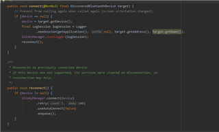

  • Hello again,
    I did not manage to solve the problem. In the Microcontroller I changed the _MIN and MAX interval to 10-20ms value. But for the Blinky application I cannot find this variable/whater it is MIN_CONN_INTERVAL or MAX_CONN_INTERVAL.
    In the BlinkyActivity.java there is a call:
    mViewModel.connect(device);
    The parameter device is the selected Discovered bluetooth device from list.
    The connect function can be found in BlinkyViewModel.java
    Can you take a look in the bellow code and tell me where should I change the connection interval? thanks

    import android.app.Application;
    import androidx.lifecycle.AndroidViewModel;
    import androidx.lifecycle.LiveData;
    import androidx.lifecycle.MutableLiveData;
    import android.bluetooth.BluetoothDevice;
    import androidx.annotation.NonNull;
    import com.example.a1remotecar.R;
    import com.example.a1remotecar.blescanner.adapter.DiscoveredBluetoothDevice;
    import com.example.a1remotecar.blescanner.profile.BlinkyManager;
    import com.example.a1remotecar.blescanner.profile.BlinkyManagerCallbacks;
    import no.nordicsemi.android.log.LogSession;
    import no.nordicsemi.android.log.Logger;
    public class BlinkyViewModel extends AndroidViewModel implements BlinkyManagerCallbacks {
    	private final BlinkyManager mBlinkyManager;
    	public static BluetoothDevice mDevice;
    	// Connection states Connecting, Connected, Disconnecting, Disconnected etc.
    	private final MutableLiveData<String> mConnectionState = new MutableLiveData<>();
    	// Flag to determine if the device is connected
    	private final MutableLiveData<Boolean> mIsConnected = new MutableLiveData<>();
    	// Flag to determine if the device has required services
    	private final MutableLiveData<Boolean> mIsSupported = new MutableLiveData<>();
    	// Flag to determine if the device is ready
    	private final MutableLiveData<Void> mOnDeviceReady = new MutableLiveData<>();
    	// Flag that holds the on off state of the LED. On is true, Off is False
    	private final MutableLiveData<Boolean> mLEDState = new MutableLiveData<>();
    	// Flag that holds the pressed released state of the button on the devkit.
    	// Pressed is true, Released is false
    	private final MutableLiveData<Boolean> mButtonState = new MutableLiveData<>();
    	public LiveData<Void> isDeviceReady() {
    		return mOnDeviceReady;
    	public LiveData<String> getConnectionState() {
    		return mConnectionState;
    	public LiveData<Boolean> isConnected() {
    		return mIsConnected;
    	public LiveData<Boolean> getButtonState() {
    		return mButtonState;
    	public LiveData<Boolean> getLEDState() {
    		return mLEDState;
    	public LiveData<Boolean> isSupported() {
    		return mIsSupported;
    	public BlinkyViewModel(@NonNull final Application application) {
    		super(application);
    		// Initialize the manager
    		mBlinkyManager = new BlinkyManager(getApplication());
    		mBlinkyManager.setGattCallbacks(this);
    	 * Connect to peripheral.
    	public void connect(@NonNull final DiscoveredBluetoothDevice device) {
    		// Prevent from calling again when called again (screen orientation changed)
    		if (mDevice == null) {
    			mDevice = device.getDevice();
    			final LogSession logSession
    					= Logger.newSession(getApplication(), null, device.getAddress(), device.getName());
    			mBlinkyManager.setLogger(logSession);
    			reconnect();
    	 * Reconnects to previously connected device.
    	 * If this device was not supported, its services were cleared on disconnection, so
    	 * reconnection may help.
    	public void reconnect() {
    		if (mDevice != null) {
    			mBlinkyManager.connect(mDevice)
    					.retry(3, 100)
    					.useAutoConnect(false)
    					.enqueue();
    	 * Disconnect from peripheral.
    	private void disconnect() {
    		mDevice = null;
    		mBlinkyManager.disconnect().enqueue();
    	public void onBatteryLevelChanged(BluetoothDevice dev, final int bateryVal) {
    	public void onClickSendDCMotorValue(final byte dcValue) {
    		mBlinkyManager.sendDriveMotorValue(dcValue);
    		try {
    			Thread.sleep(40); // wait before next execution
    		} catch (InterruptedException e) {
    			e.printStackTrace();
    	public void onClickSendServoMotorValue(final byte servoValue) {
    		mBlinkyManager.sendServoMotorValue(servoValue);
    //		try {
    //			Thread.sleep(40); // wait before next execution
    //		} catch (InterruptedException e) {
    //			e.printStackTrace();
    	public void onClickSendLEDSState(final byte servoValue) {
    		mBlinkyManager.sendLedState(servoValue);
    //		try {
    //	public void toggleLED(final boolean isOn) {
    //		//mBlinkyManager.send(isOn);
    //		mLEDState.setValue(isOn);
    	@Override
    	protected void onCleared() {
    		super.onCleared();
    //		if (mBlinkyManager.isConnected()) {
    //			disconnect();
    	@Override
    	public void onDeviceConnecting(@NonNull final BluetoothDevice device) {
    		mConnectionState.postValue(getApplication().getString(R.string.state_connecting));
    	@Override
    	public void onDeviceConnected(@NonNull final BluetoothDevice device) {
    		mIsConnected.postValue(true);
    		mConnectionState.postValue(getApplication().getString(R.string.state_discovering_services));
    	@Override
    	public void onDeviceDisconnecting(@NonNull final BluetoothDevice device) {
    		mIsConnected.postValue(false);
    	@Override
    	public void onDeviceDisconnected(@NonNull final BluetoothDevice device) {
    	@Override
    	public void onLinkLossOccurred(@NonNull final BluetoothDevice device) {
    	@Override
    	public void onServicesDiscovered(@NonNull final BluetoothDevice device,
    									 final boolean optionalServicesFound) {
    		mConnectionState.postValue(getApplication().getString(R.string.state_initializing));
    	@Override
    	public void onDeviceReady(@NonNull final BluetoothDevice device) {
    		mIsSupported.postValue(true);
    		mConnectionState.postValue(null);
    		mOnDeviceReady.postValue(null);
    	@Override
    	public void onBondingRequired(@NonNull final BluetoothDevice device) {
    		// Blinky does not require bonding
    	@Override
    	public void onBonded(@NonNull final BluetoothDevice device) {
    	@Override
    	public void onBondingFailed(@NonNull final BluetoothDevice device) {
    	@Override
    	public void onError(@NonNull final BluetoothDevice device,
    						@NonNull final String message, final int errorCode) {
    		// TODO implement
    	@Override
    	public void onDeviceNotSupported(@NonNull final BluetoothDevice device) {
    		mIsSupported.postValue(false);
