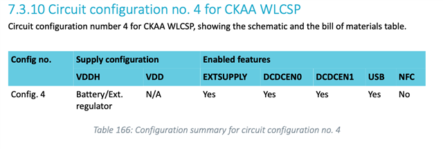

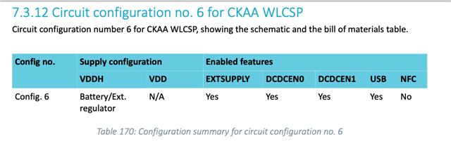

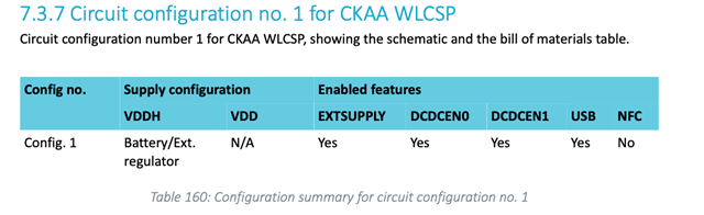

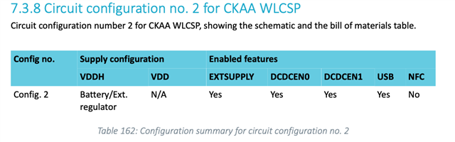

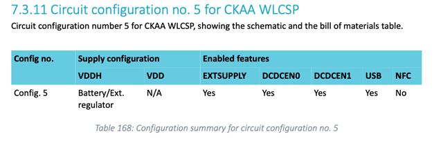

The nRF52840 product specification version 1.1 contains for the table 160, 162, 164, 166, 168 and 170 the very same content. I suspect, that the correct content can be taken from the corresponding tables for the aQFN package.
best regards,
Torsten

Hi Torsten,
Some of the values are the same, but not all of that.
-Amanda H.
I can't see any difference in my copy of the document (V1.1). Maybe you are working already with a newer, not published version?
Hi Torsten,
Nice catch. I will report it. In the meantime, you can refer to Table 147: Circuit configurations in the PS or Table 2. Circuit configurations in this Reference circuitry documentation.
-Amanda H.
Hi Torsten,
-Amanda H.
