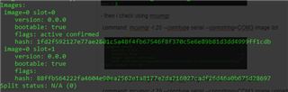

So, i have been trying to perform a DFU over serial using the method mentioned here by Hung Bui.
Here is a summary of what i did:
- build and flash mcuboot
- build and flash smp_svr and i get this:
- then i check using mcumgr
 command: mcumgr -t 20 --conntype serial --connstring=COM3 image list
- then i try uploading the image (im using the hello world sample)
 command: mcumgr -t 20 --conntype serial --connstring=COM3 image upload app_update.bin
app_update.bin is the signed version of the image made when the application is build using SES
then i check using image list
which also seems ok.

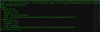

- HERE is the problem
when i use the command, mcumgr -t 20 --conntype serial --connstring=COM3 image test 88ffb564222fa4604e90ea2562e1a8177e2da216027cadf26d46a0b675d28697
it shows this and then i reset the chip for the image to be swapped, but i get this
At this point, its just stuck here even if i try reset multiple times.
Do you guys have any advice for me? not sure what im doing wrong.
