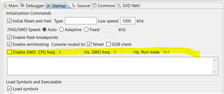

I know I can set the TRACEMUX pins to 0 to enable the GPIO instead of SDO. I do this on the first line of the program.
My problem is that when I click debug, from the time that hit debug to run, pin P1.00 is being driven high. This is unfortunately an enable pin for a high current item and it is causing the design to surge power until I can hit run or step to turn off the TRACEDATA pin. There is a pull-down on the pin, so I know it is being driven to Vdd. I can see it on the scope.
Is there a way to turn this off during program, or do I just need to move the pin? It is supposed to be a retained register, but obviously reprogramming for debug is resetting it.
