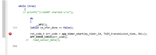

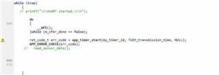

    This doesn´t work:
            nrf_delay_ms(20);
            ret_code_t err_code = app_timer_start(my_timer_id, TWIM_transmission_time, NULL);
          //  read_sensor_data();
    Where is the difference? The only difference is, that in first example the function "read _sensor_data()"  is called automatically and in the second example the function "read _sensor_data()"  is called by expiration of the timer. Because of that, I don´t think there is someting wrong with my function rather someting with the timer procedure...

    Which function is returning this error code, nrfx_twim_xfer? And, what do you mean by "stuck", does the device reset?
    The difference is that the CPU is free to continue with other tasks in the meantime, while the timer is running. In your current setup, this means that the CPU will run for 10 seconds while the timer is still running. The question then becomes, what are you doing in these 10 seconds? If the code above is your entire main loop then the CPU will immediately enter the loop again, and try to start the timer again in the next loop iteration. From the
    app_timer_start
    documentation we see that this function call is ignored if the timer is already started.
    What you should instead do is therefore to either go to sleep, or perform some other task.
    Could you show the entire contents of your current main function?
