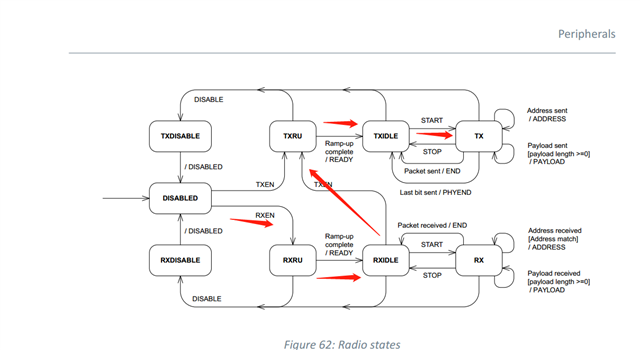

In my application, I use nrf52811 to relay data to make the data go further. If data is sent from point A to point B, point B receives the data and then forwards to point C. The sending and
receiving of point B use the same chip and wireless transceiver circuit.
I see the following state diagram from the specification of 52811 and think that 52811 should be able to achieve this function. I tried, but no success!
Can receive the data packet at point A, but failed to forward the data to point C.
Can anyone help me solve this problem? thanks
