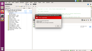

We have custom board based on nRF52833 SoC. We are trying to use SDK_v16.0.0/examples/ble_peripheral/ble_app_uart/pca10100/s140.
Using Segger Embedded studio, program is not downloading to flash but with nRF Connect it is downloading.
Is it the problem with SES?

    Why SES cant even program?

    Are you able to connect to the JLink from SES? Is there an error prompt when you try to use the "Target->Download" button? If so, which one?

  • Target->Connect J-Link

    Target->Download File->Download

    Preparing target for download
      Executing Reset script TargetInterface.resetAndStop()
      Reset: Halt core after reset via DEMCR.VC_CORERESET.
      Reset: Reset device via AIRCR.SYSRESETREQ.
    Downloading 's113_nrf52_7.0.1_softdevice.hex' to J-Link
      Programming 2.7 KB of addresses 00000000 -- 00000aff
      Programming 105.0 KB of addresses 00001000 -- 0001b3ff
    It says Generic Error
    Is there any particular SES version for this nRF52833 SoC? We use version 4.22.
    This could be caused by a faulty connection, or a bad Segger install.
    Could you ensure that the connection between the nRF52833 SoC and the J-Link is in good condition?
    Please see this ticket for details around resolving a bad Segger install - in essence it seems that you will need to reinstall Segger and the related JLink drivers to resolve this issue.
    Could you reinstall SES and J-Link driver, and let me know if this resolves your issue?

    Yes after reinstalling it is working fine.
