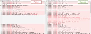

  • Hi Hung, sorry for the delayed response.
    I finally had a chance to try 9600 bps. I have a board that's consistently failed at the same spot. So, even with 9600 it's still failed. The failure is the embedded side didn't send the checksum ("CalcChecksum" no response). When I did a retry from the PC side (resend the command, 0x03), got mismatch checksum.
    Am I not supposed to do the retry?
    Any other idea I can try?
  • I don't have further idea except that you may need to run the bootloader in debug mode and check why it doesn't response to the CalcChecksum command. I suspect that it crashed earlier than that or it didn't receive the packet properly.
    But could you confirm that you only see the issue in 3 boards and only one board always failed ? When you test the other 2 board at 9600 would they also failed ?

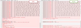

  • Hi Hung, 9600 still failed on one board. The other two work, but I need to test more to check.
    The weird thing is, when it failed, the packet sequence is different, there are discrepancies. I used the same file, I don't understand why would the payload/sequence be any different, or why would it's parsed differently. It almost looks like the issue is in the file parsing.
    Here's what I meant:
    At the beginning:
    At the end:
    Let me know what you think.
  • Hi Harry,
    Thanks for the trace. What I can see in the trace is that the main difference is the offset of 141 bytes in the Failed case. This showed that the bootloader already received the init packet and because of that the DFU master (I assume you are using nRFutil ? ) skip sending the init packet and simply execute it.
    After that the DFU master continue to transfer the image until it finish the first object and ask for CRC check. The failed board didn't response to the request and on the retry it responded with the CRC of the init packet (exactly the same as in the first response to the init packet Select command at the beginning). So for some reason the bootloader didn't accept the first object of the application image.
    What I would suggest is to try to do a chip erase to clean the board and try again. Then you can record a trace with out the offset as in the current test.
