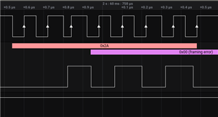

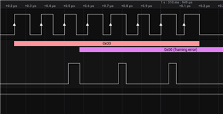

I've been observing a strange behaviour on the MOSI line using SPI2 in Mode 0(nRF52832) with connected ST7789 based display,
The data happens to be not available at the time of the sampling clock. This happens rarely, only in Mode 0  and only with the mentioned peripheral(ST7789).
Using different display with ST7735, this behaviour is not visible:
Logically this could be explained with some issues with the ST7789 hardware, but keeping in mind that the data pin is solely input(not a tri-state) and the the fact that this is not happening when Mode 3 is used, I am really confused what can be the reason.

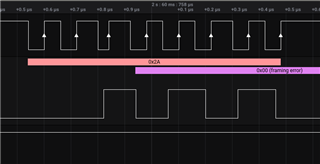

Mode 3, ST7789(working fine):
The code used for both displays is the same(no board reprogramming, just plug and play), snapshot follows:

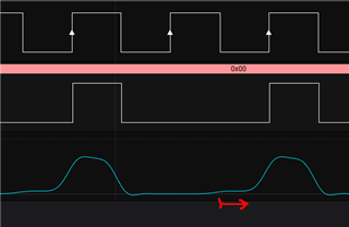

  • Thank you for the hint.
    It seems that I have misread the specs for ST7789 and following you comment I made a test on 250kHz with analogue channel to find my mistake(The pin could be 3-state in some cases).
    It is clearly visible that MOSI is driven high but on the other side is pulled low until the clock appears:
