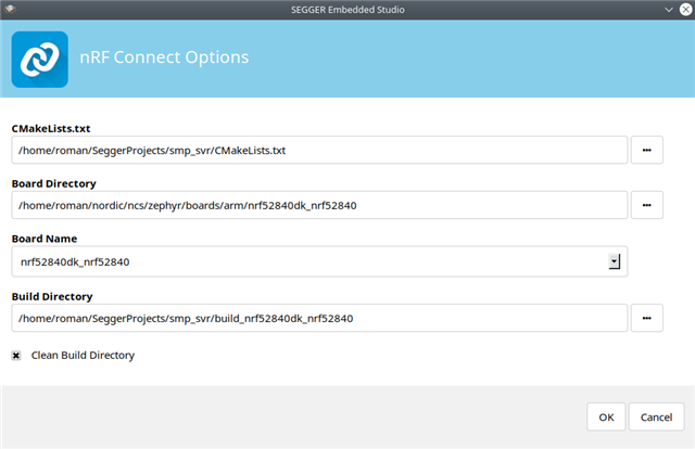

  • Good evening, Simon!
    Basically I followed this guide developer.nordicsemi.com/.../ug_nrf5340.html
    Firstly, according to "SMP Server Sample" (developer.nordicsemi.com/.../README.html I connected nRF52840 DK through USB, opened serial terminal "minicom -b 115200 -8 -D /dev/ttyACM0" and built and flashed MCUboot, using the following commands:
    west build -b nrf52840dk_nrf52840 -d build_mcuboot bootloader/mcuboot/boot/zephyr
    west flash -d build_mcuboot

    Secondly, I located "/ncs/zephyr/samples/subsys/mgmt/mcumgr/smp_svr" example, added the line "CONFIG_MCUMGR_SMP_BT=y" to "prj.conf", open nRF Connect SDK Project from SEGGER Embeded Studio for ARM (see a screenshot below). And finally, I built and run the project: Build -> Build and Run.
    UART output after it:

    Thirdly, I modified the example "SMP Server Sample" and merged a blinky example ("/ncs/zephyr/samples/basic/blinky") to clearly show the difference after upgrading new firmware. I built it and uploaded it to a mobile phone.
    And finally, I launched "nRF Connect for Mobile" app (Version 4.24.1) on the mobile phone, scanned, connected to my device with name "Zephyr", taped DFU, located new app_update.bin file and chose "Test and Confirm". After upgrading the firmware I could see a blinking led on the board.
