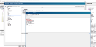

    5. Right, I am confused where I have to define this and take out PCA10056 being defined since I am using the example from the SDK to make the project?
  • 3. You can keep them as in the PCA10056 board file
    4.  Sorry, this was entirely my fault, I glanced a bit too quick on the board file. Forget my previous point, just make sure that the I2C pins are assigned to the left or under side of the chip as the pins on the right side and upper side of the IC are marked as low frequency/low drive in the product specification.
    5. This is usually done as part of the pre-processor defines. I've included a snippet from SES, if you use GCC then it's done in the bottom of the makefile.
