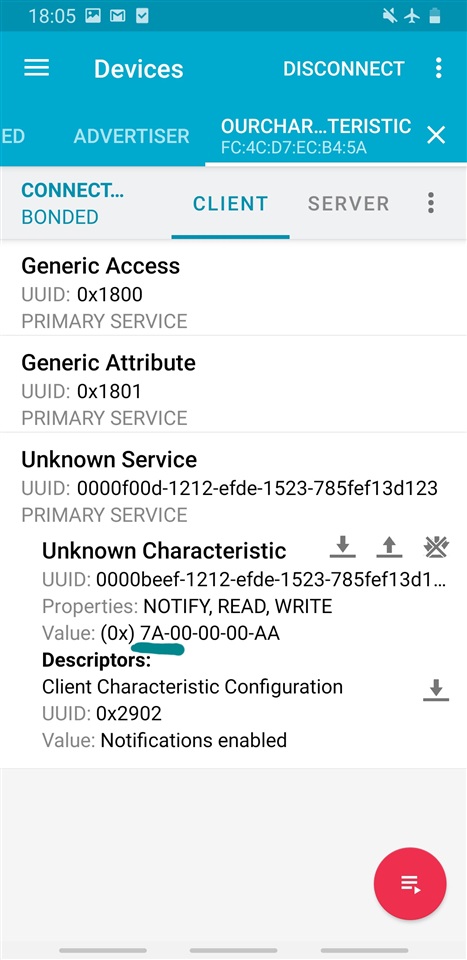

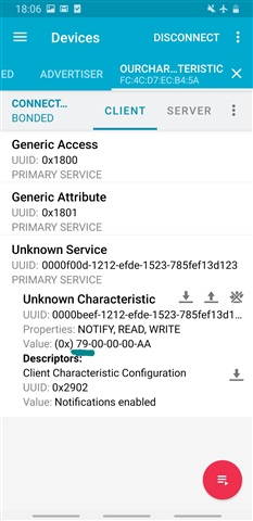

    I have some new questions: going on with the same tutorial, I tried to send the values of the temperature to the application, as notification, but I am a bit confused:
    1. How should I interpret these values? Should I translate them from hexa to decimal? Although 0x76 means 118 dgr in decimal, so I guess there should be another trick.
    2. Why are the first bits of the characteristic changed? I understood that the least significant bits should be changed, according to the different temperatures experienced by the sensor. Please see the two attachments:
    Thank you for noticing me regarding the summer-holidays delay.
    Best regards, Marry
  • Hi Marry,
    See this post.
     You could use ble_gatts_hvx_params_t::offset to modify the offset within the attribute value. See this post.
    -Amanda H.
    See this post.
    Unfortunately, this does not answer my question. I was confused of how to interpret that value, since 0x76 means 118 dgr in decimal. And this post confirms what I thought, i.e. that I should convert the data from hexa to decimal. But still, I do not understand my 118 (decimal) degrees value.
    Additionally, one could say that the last bytes (AA) are the temperature, but that's 170 dgr in decimal, therefore, it also does not make any sense.
