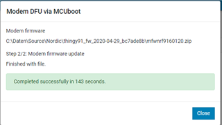

  • I found a new problem, sigh.
    I tried to update the firmware. I download this file:
      thingy91_fw_2020-04-29_bc7ade8b.zip
    I unpack it.
    I start the programmer. I switch on the Thingy when press the big button and connect it to usb.
    I connect with the programmer and use the button "Update modem"
    I direkt it to the file "mfwnrf9160120.zip"
    The programmer did program some file to the thingy. It looks good.
    Modem DFU starts to write...
    Writing C:\Daten\Source\Nordic\thingy91_fw_2020-04-29_bc7ade8b\mfwnrf9160120.zip to device
    Modem DFU completed successfully!
    I switched off and on the device. But it did not work anymore. No blinking led.
    I don't understand what I did wrong!
    Is it now time to connect the j-link Ultra and did the real work? Slight smile

  • Okay, I found the nordic page in internet that explain that the device firmware is deleted when I update the modem firmware. BTW: Your link above to the explanation is dead. So I had search in internet for it.
    I wrote now some firmware inside and the red led is blinking.
    C:\Daten\Source\Nordic\thingy91_fw_2020-04-29_bc7ade8b\images_dfu_hex\debug\thingy91_nbiot_dfu_debug_2020-04-29_bc7ade8b.hex
    Do I need to program more than one file? It is hard to understand what happens or not.
