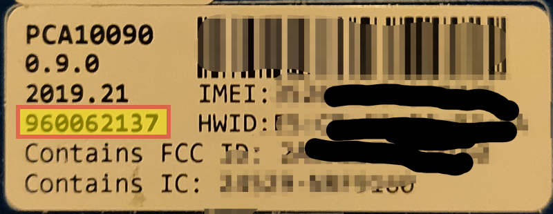

PCA10090 programming customer board via debug out
One of our modules using PCA10090 0.8.2 programming and production nRF9160/nRF52840  modules.
Our customer reported that they can't use PCA10090 0.9.0 re-programming these modules.
Does there is any difference between 0.8.2 and 0.9.0?
They have 20 modules 2 PCA10090 and has the same problem.
They already checked the cable and connection.
 nrfjprog --version
--->nrfjprog version: 10.9.0
--->JLinkARM.dll version: 6.80d
nrfjprog --recover
 --->ERROR: JLinkARM DLL reported an error. Try again. If error condition
--->ERROR: persists, run the same command again with argument --log,contact Nordic
--->ERROR: Semiconductor and provide the generated log.log file to
 them.
Do you know what might caused this problem.
Would you please help.
Thanks you.
