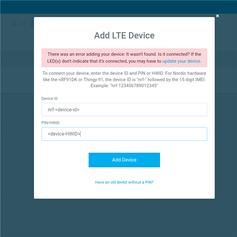

6. Tried to add to the device to nrf cloud, by choosing to add LTE Device and "nrf-<15 Digit IMEI>" with respective HWID. ==> But no luck.
We have used the same device -id form for both when getting new certificates and while adding the device to cloud.

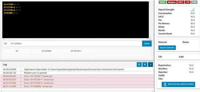

    We faced the following issues as follows (Screenshot attached):
    1. AT Commands failed to respond on LTE Link Monitor.
    2. Error in Updating Certificates.
    3. Device failed to add to the cloud.
    From this image it looks like something is not right. The commands should return "OK" after AT+CFUN=4. If "OK" is not returned, try resetting the board manually with SW2 while connected to Link Monitor? Do you see Zephyr booting? Try the procedure again and it might work. Let us know if you are still unable to see "OK" returned from the commands.
