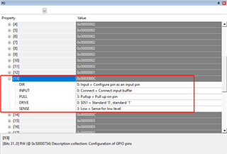

  • after I can not wake up from idle mode
     How do you know that you've not woken up?
    why do you call sd_app_evt_wait twice?
  • Set a breakpoint on before you go to sleep and read the GPIO's PIN_CNF[wake_up_pin] register to verify that the gpio has been configured correctly.
    Then use a logical analyzer to verify that you are sending the correct signal to wake_up_pin when you push the button.
  • I am sure,the keybutton config is ok.Because before enter system on,the nrfx_gpiote_irq_handler can be called.If I call the sd_app_evt_wait twice,then enter system on mode,after the nrfx_gpiote_irq_handler cannot be called.But I can find the gpiote events_port has generate a event.

  • Haakonsh,Thanks for your patient responses these days.It was solved,when i call the sd_app_evt_wait once.
    Because I don’t have a deep understanding, I think that after calling this api, the subsequent code will no longer run, so I always think that the chip does not enter the sleep mode, in fact, the sleep management function has been called in the main loop. Later I also tested Current consumption is within 10ua, meeting the requirements.
