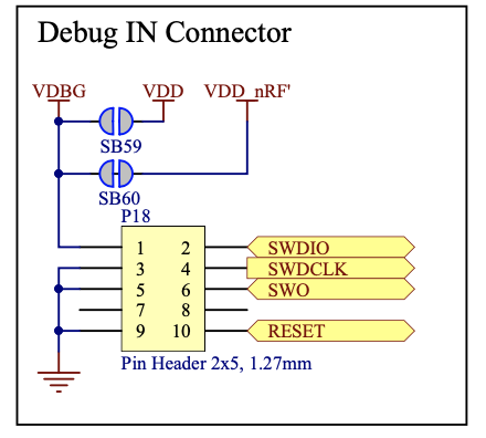

  1. How can I program the NRF52840 when it's on my own board? Other posts have said that it's as simple as using an nrf52 dev kit as an external debugger and connecting the SWDIO, SWCLK, VDD, and GND pins (https://devzone.nordicsemi.com/f/nordic-q-a/30127/programming-custom-pcb-nrf52840). Is there any initial set up I have to do in addition? I also have access to a Jlink debugger, is it possible to use that as an external debugger with the nrf52840?

    1. The nRF52 is programmed through the SWD interface which uses a SWDCLK line and a SWDIO line. You would need to route VDD and GND in addition to the SWD data and clock lines to a header (to make them externally available for a debugger). J-link is the debugger that we officially support so good choice. Also, our nRF52 DKs and nRF52840 DKs comes with an external debugger that can be used for programming custom boards. If you take a look at the schematic of the nRF52840 DK then you'll see that the SWD pins are routed to the onboard interface chip which acts as a onboard debugger.
