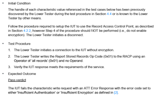

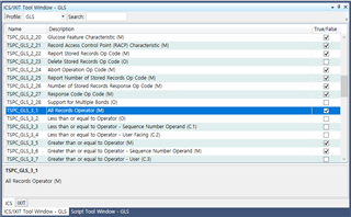

    Check this in the items below.
    TSPC_GLS_2_22
    TSPC_GLS_3_1
    GLS/SEN/SPE/BI-09-C : RACP write without Authentication

  • It could be the read/write permissions of the individual characteristics.
    In the examples/ble_peripheral/ble_app_gls/main.c on line 433, the permissions for the GLS characteristics is set to JustWorks. Try setting all the permissions for the GLS characteristics in services_init()to SEC_OPEN.
    If this is an actual product you're making you need to make sure to use the appropriate security levels when you deploy.
