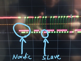

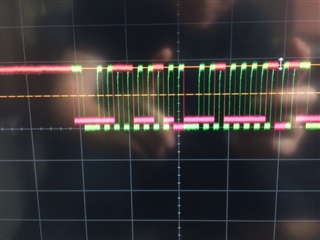

I am using P0.00 as SDA and P0.01 as SCL on nRF52833, And I got waveforms like below when I am doing I2C transactions:
the red waveform is SDA and the green waveform is SCL.
As shown in the picture the nordic chip doesn't pull the SDA line (red) all the way down to voltage zero when it's 0.
We already have 1.8V and a pull up resistor of 1.8K ohm on both pins.

    Yes we want a close zero. Currently that "zero voltage" on SDA is 0.24V.
    If you examine my waveform closely, you will find that the SDA was driven to close zero better by the slave device compared to when the Nordic chip was driving it. see my picture below:
    Also SCL (green line) is able to drive to close to zero just fine.
    This means the Nordic chip should be able to do better driving SDA to zero.

  • Two comments might help improve this. First the nrf_gpio_cfg() to change the SDA pin to H0D1 has to be invoked after setting up the I2C, not before, as the i2c (twi) init will overwrite the H0D1 settings with low-drive S0D1.
    Second when using the (slow) i2c/twi clock speed of 100kHz a pull-up on SDA of 1k8 is overkill; that pull-up could be changed to (say) 4k7. Such a change would improve the low-level if correctly setting H0D1 doesn't get the level low enough to meet your requirements.
    Why does the slave device perform better than the Nordic device? Because if it is a dedicated i2c/twi chip it has much higher drive capability as it was designed to only drive SDA whereas the Nordic is a general purpose i/o pin allowing use of any pin for SDA  (unlike some other MPUs which might have dedicated drive pins which can't be changed).
    Setting H0D1 after the i2c/twi init allows use of a pull-up as low as 1k0 at 400kHz, by the way. 'course, the lower the pull-up resistor value the more the coin cell has to supply in a case where longevity is required.
