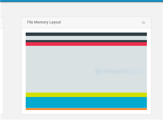

  • Good to hear that you were able to fix the upload issue by adding some delays. Regarding the "buttonless" mechanism, is the command to enter DFU mode sent over BLE or UART? The SDK does not provide any example for buttonless entry with UART, but it is pretty easy to implement. Just add a call nrf_pwr_mgmt_shutdown(NRF_PWR_MGMT_SHUTDOWN_GOTO_DFU); when you receive the command to enter DFU.
  • I m using buttonless over UART.
    still i m not enter into boot mode after giving below command.
    #define BOOTLOADER_DFU_START 0xB1
    void boot_mode()
     nrf_delay_ms(100);
                   NRF_POWER->GPREGRET = BOOTLOADER_DFU_START;
                  nrf_delay_ms(100);
                  NVIC_SystemReset();
    what i did before merging part
    1) bootloader hex + Bl settings merged output1.hex.
    nrfutil settings generate --family NRF52840 --application ble_app_rscs_c_pca10056_s140.hex --application-version 1 --bootloader-version 1 --bl-settings-version 1 --key-file private.key bl_settings.hex
    2) application hex + softdevice  hex merged output2.hex
    3. output1.hex and output2.hex merged together with final output file
    mergehex --merge output1.hex output2.hex  --output final_out.hex
    after flashing the final out hex to my board running in application at first then
    when changing to bootloader using buttonlesss with above inserted code .its entering but not properly timeout and also when sending  a new firmware through serial not updating with the new firmware.
    application memory
    FLASH_PH_START=0x0
    FLASH_PH_SIZE=0x100000
    RAM_PH_START=0x20000000
    RAM_PH_SIZE=0x40000
    FLASH_START=0x26000
    FLASH_SIZE=0xda000
    RAM_START=0x20001cd0
    RAM_SIZE=0x3e330
    uart bootloader memory
    FLASH_PH_START=0x0
    RAM_PH_SIZE=0x40000
    FLASH_START=0xe4000
    FLASH_SIZE=0x1a000
    RAM_START=0x20000008
    RAM_SIZE=0x3fff8
    here is my memory location
    kindly help me out. i have been hold on here for past 3 days.
  • Looks like you are using the same code as here: https://devzone.nordicsemi.com/f/nordic-q-a/64170/ota-over-serial-merging-with-application. Is the Softdevice enabled when you call boot_mode() in your app?
  • Very first time i flashed secure uart dfu through jlink.
    D:\NRF_SDk_latest\nRF5_SDK_15.2\nRF5_SDK_15.2\examples\dfu\secure_bootloader\pca10056_uart_debug\ses
    In loader i changed to ../../../../../components/softdevice/s140/hex/s140_nrf52_6.1.0_softdevice.hex
    After i send only application file from my master to NRF. It worked.
    what did i wrong in that sending application file?
  • Does the bootloader start out in DFU mode the first time you program it with the Jlink? It sounds like maybe the buttonless mechanism is not working as intended. I.e., not putting the device into Bootloader DFU mode.
