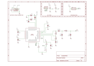

my nrf51822 QFABC1 not working BLE , i used sdk 12.3.0 and uploaded softdevice is s130, and also I upload
I attached my schematics diagram also
please support any mistake in this schematics
ble_app_hrs ,and ble_app_beacon ,But not working BLE

why is R1 connected to DEC2? Try to remove it.
What antenna are you using?

Thank you for supporting me ,i will attach reference circuit also
my circuit has any problem
