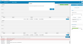

The Power Profiler Kit(PPK) is not able to measure current consumption. I got this notification asking to reprogrammed the device, I clicked yes and then-after it said failed to read ppk                                                                                                                                                                                                        metadata.I went through Nordic DevZone and User Manual for PPK..

Before python v2.7.12 support ended, I was able to reprogrammed the PPK following the steps from manual, and measure current consumption. Currently, I am not able repraggemed it, is it because of python v2.7.12 ended? Is there any other way to reprogram the PPK?
  • Hi
    Can you confirm that you have cut the SB40 solder bridge on your nRF52840 DK? I just tried to download the PPK firmware myself using the Power Profiler app in nRF Connect for Desktop and did not have any problems doing so. If the PPK is mounted on top of the nRF52 DK, and the solder bridge is cut correctly, pressing Yes in the "Device must be programmed" pop-up window should flash the PPK for you and open the PPK without problems. If that doesn't work, you can try to power cycle the PPK (and the DK it's mounted on) to see if that helps.

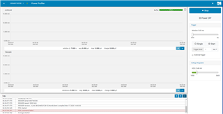

    Yes, I cut the SB40 solder bridge on nRF52840 DK and press Yes in the "Device must be programmed" pop-up window. It started the PPK afterwards when I press start to see the current measurement. It shows PPK command failed as shown in the below image.                                                                                                                                 Tried to power cycle the PPK(and the DK it's mounted on), getting same PPK command failed.

    A few things you can try:
    • Erase the application on the PPK completely by using the following nrfjprog command: nrfjprog -e
    • If you're using a USB hub you can try changing the USB port or connecting the DK/PPK directly to the computer.
    • Check the USB cable you're using and try using another cable as it might be bad.
    • Make sure that the J-Link isn't running already, as not closing a previous instance using the J-Link driver might cause a bad connection with the board.
    What operating system are you running on your computer?
    Simon

    I am running on windows 10. I tried to erase PPK mounted on nRF52840 DK, with power select, DUT select and COM switch to DK, with connecting USB cable to nRF52840 DK, LED on nRF52840 and LED2 on PPK should turn on right? (solder bridge was cut).
    Here, in my case only the Led on nRF52840 turns on. After Erasing it using the command nrfjprog -e, it then turned LED2 on. Next, i stated Power Profile on nRF Connect then select yes in "device to be programmed window". After selecting the start to measure current consumption again it gave, PPK command failed.   Meanwhile, LED1 on PPK turned on too.

  • Okay
    The LED behavior you're describing seems correct to me.
    A few more things:
    • Make sure that the nRF power source switch on the DK is set to VDD, the VEXT->nRF switch is set to OFF, and that the nRF ONLY|DEFAULT switch is set to DEFAULT.
    • Check that you have the latest version of nRFConnect for Desktop and the Power Profiler app.
    • Check that you have the latest JLink drivers.
    Can you confirm that you haven't done any modifications to the DK that might have interfered with the routing on it? Can you also provide a picture of the PPK mounted on the DK so I can have a look?
