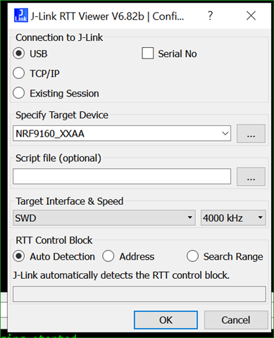

  • Could you share the full log from the programmer app:  after running the modem update ?
    Also please shut all other serial terminal e.g. like RTT Viewer, so that the Jlink is only used when using the programmer app.
    Do you have any idea what may have happened between the flashing the ones that worked vs. the ones that does not work?

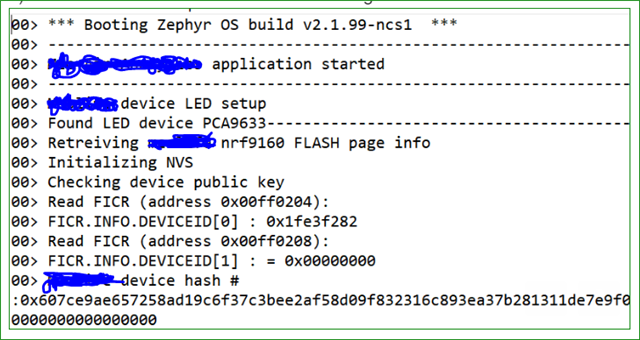

  • The RTT Viewer was required by our customer to verify the public and private key.
    The steps I did were below.
    1) Open RTT Viewer and verifiy the device is connected.
    2) Open nRF Programmer, at first i did not perform erase all command, just straight to update modem
    and flash hex. I did it for the 15 samples or so and it worked. Then after some time the error came out.
    ***by the way, before this issue I flashed all 20 units with no problem. Then the customer required to view the log file for public and private key that is why I needed the RTT Viewer and reflash the units again*** Is it possible that the nRF9160 was corrupted or some sort?
    Here is the log file data.

    Do you still get issues if you do not open RTT Viewer first?
